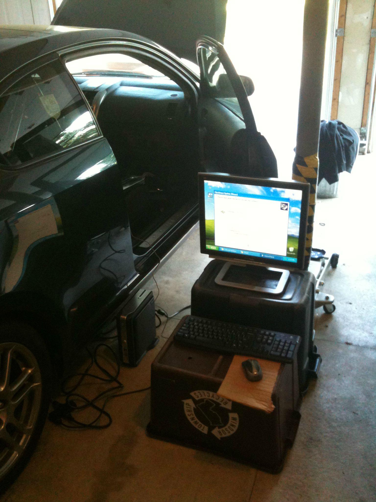

Hmm... still no luck connecting, even with Win XP. I double checked all the jumpers, tried disconnecting the MAF and MAP sensors, and just using the stock ECU - the car still doesn't start.

Here's my setup by the way, haha:
