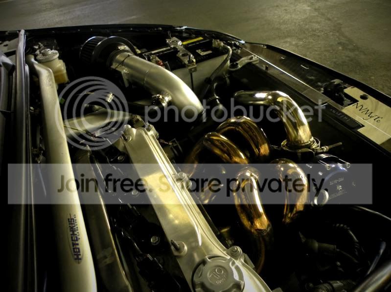

I did mine in about 1 1/2 hours
I first sanded with 220 grit, then 600, then 2000. Polished it by hand with some turtle wax rubbing compound and had great results. They turn a gold'ish color after a few minutes of running, I loved the look
