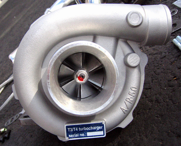

you are better off buying the blue tag serial plated t04e turbochargers. those wuxi mingzhu one you've shown are mass produced in great quantities and have a higher failure rate because of that. most of the chinese turbochargers require an oil restrictor and about one week proper break-in period without WOT in order to set everything in.

do you know exactly which one he has? there are at least five different types of t04e & t3/t4 turbochargers made by about four various chinese companies. a picture of the compressor housing would be nice.
