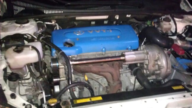

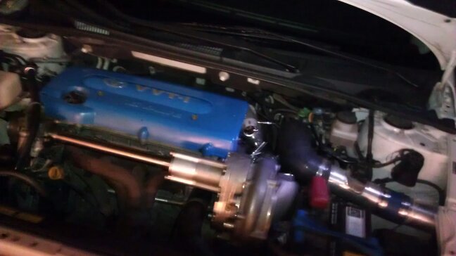

This is my set up don't mind the header it's stock until I get the dezod one.

concerning the header, you should really put the heatsheild back on or heatwrap it asap, the life expectancy of those supercharger shafts are greatly reduced by such heat.

And The shaft is from gompka so it's been rebuilt. i dont got the heat shield i bought this kit used and was missing some parts I'm going to be getting the dezod catted header I got a colder thermostat 61 but I don't know if that helps cool it down a bit

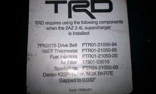

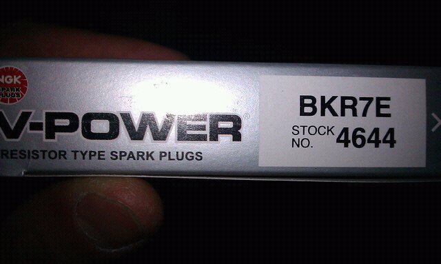

can it be the spark plugs i got ngk Bkr7e and gapped them to what it said on the installation

you should really just read that thread thatt tCb00b posted, is very informative.
You cant determine instantaneous AFRs without a gauge. If you're gonna be doing more custom things pick up an AEM Uego.
Are the spark plugs you're running NGK BKR7E-11 or BKR7EIX-11? If theres no IX, then they are copper plugs and will definitely be causing you problems. If you want to run copper you would once again need a tune for copper. The TRD tune is for iridium plugs which the BKR7EIX-11 are. If you are running copper plugs by accident, order these asap
http://www.dezod.com/pd_ngk_iridium_bkr7eix11.cfm

And the spark plugs are ngk bkr7e
I asked a question be4 on spark plugs hea and thats what some one recommended

I'm pretty sure those are copper plugs, which will throw off your ignition since your running a stock TRD tune.
get these: http://www.dezod.com/pd_ngk_iridium_bkr7eix11.cfm

I'll pick up those spark plugs tomorrow is the gap the same 0.032
