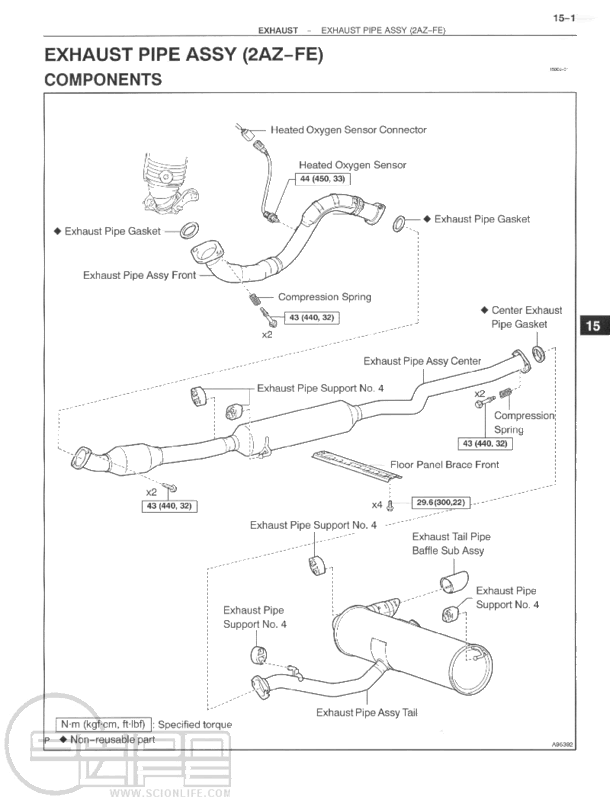

im supercharge also and want to ad a aem wideband where did u install the bung mid pipe or s pipe or headers?

on the s-pipe about 3 inches away from the stock secondary 02 sensor. when you get the wide band read the instructions, it will pretty much tell you where you should put it.

18 inches down from the head will do.. actually just choose a place where it looks clean and safe for the sensor and the harness between primary and secondary 02

im a newbie so the o2 senor on the s pipe is that the primary or secondary where is the other sensor located?

replied your pm.. the one on the spipe is the secondary O2

trying to find the header picture on the tc manual but i guess i can only download 5 pic per day lol
