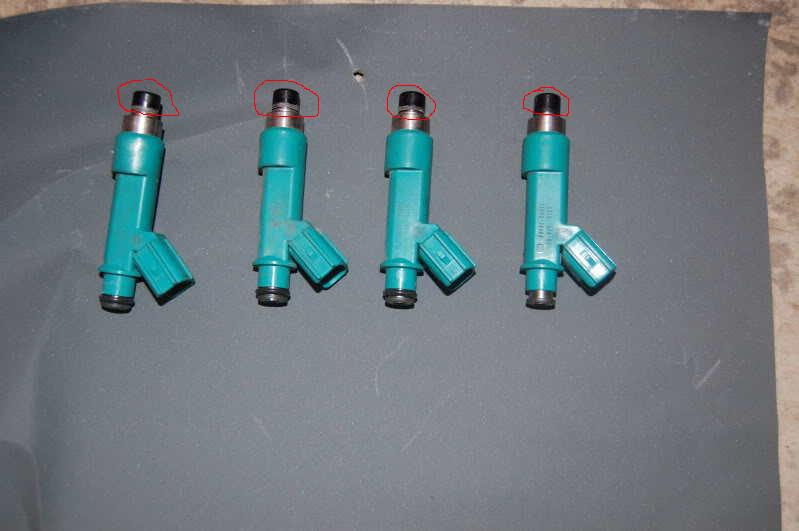

Say where to take these black things please

i don't really get the question? do you mean where to buy them?

No,no.I mean part number.Or they together with injectors?

oh. you can buy them separate. i bought an O-ring kit thing from an import part place by me.

If youre talking about the hard plastic piece on the end of the injector, that piece is not available separate from the injector. From Toyota you can buy either the injector, the bottom rubber boot that seals against the head, or the top oring. I have a set of stock injectors Id sell you for like $30 shipped if you want them. (Well provided youre within the Con. US)

Aren't those just the injector vibration insulators? ~$3 @ TRDSparks
PN# - 23291‑41010

your picture is confusing because that is just the tip of the injector.

Yes the tips. Them have lost, when established a turbo

They are called pintle caps and here is where you can buy them for our injectors:
http://injector-rehab.com/shop/Denso...Scion-Cap.html
