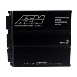

Ahh im so glad i got the aem ems from dezod. it has FULL control 4tw! Maybe try to switch to one of there boxes. There no way you can flash our ecu. or you woudlint need the hydra to begin with....
