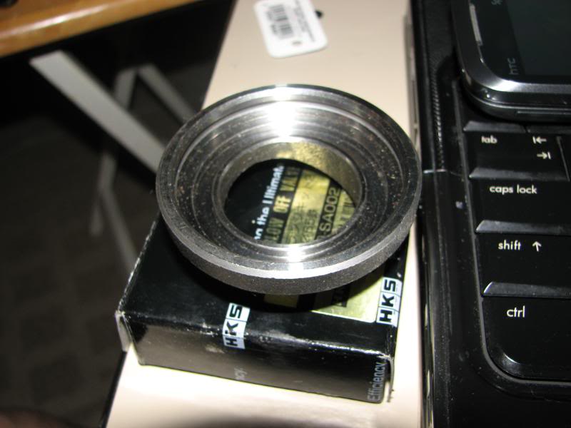

Basically I just want to know .....IS THIS THE FLANGE I NEED TO BUY??
http://cgi.ebay.com/ebaymotors/SRE-A...ht_1621wt_1041
Okey heres my problem I got the HKS SSQV and it came with this flange (1st and 2nd Pic) and then I was wondering if that would work with my pipe for my greddy kit or if I should buy a different flange??? (Pic 3) I just need to know what flange I need to make it work. Its going on my GREDDY TURBO KIT.
VVVV MY FLANGE VVVV
Uploaded with ImageShack.us
VVVV SAME FLANGE VVVV
Other Flange????

The flange in the first 2 pics seems to be a flange to convert from whatever that is to the HKS flange. The flange in the third picture is what you want but make sure you get the correct material so that it will be easier to weld together on the Greddy piping.

If your BOV location on your piping that leads to you BOV is a 2 bolt style flange, then it'll have to be removed and have the new flange re-welded in place. The flange you have already is for OEM cars that use a Bypass Valve setup where a rubber hose comes off the charge pipe and goes into the bottom of the BPV and would have another re-routing it to the intake for recirculation. That flange is to adapt the HKS to OEM cars.

Flange in the first and second picture is to recirculate your BOV.

Yeah, for your setup, the new one you bought is what he needs. The one that comes with the BOV is for OEM conversions usually because they tend to use silicone couplers on charge pipe and intake sides of the BOV unlike aftermarket kits that usually just atmospheric dump like yours will be.
You can almost see the rubber/plastic charge pipe on this car that's using that flange.
