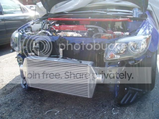

here a alright pic

Crash bar....who needs a crash bar...hahaha
MASSIVE ...lol

Haha yeah. Biggest Vibrant offers. It barely fits under the bumper.....witin mm's

how much hp is that one good up too

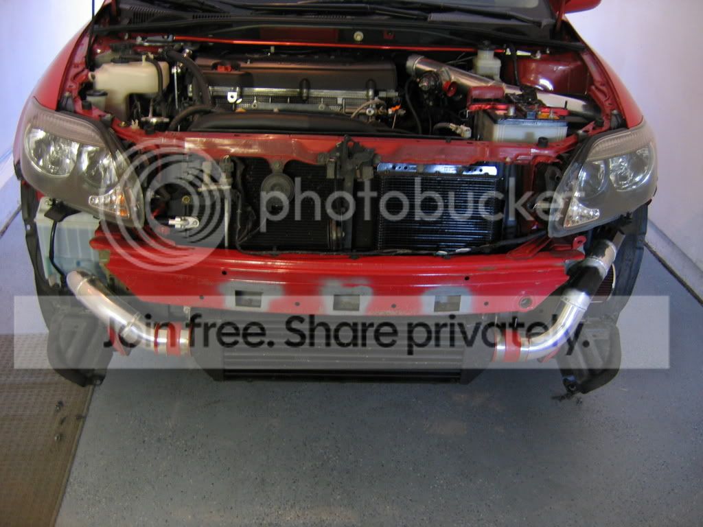

Here's mine but it's a small greddy, not sure the size off the top of my head. Crash bar still there.
I believe 800

and how much hp are u pushing

From: Motor City
340ish
