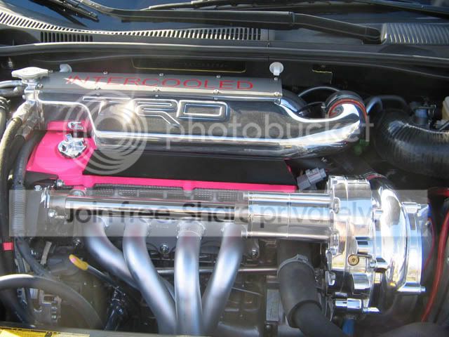

It is possible to Intercool your Supercharger on a tC.
TRD Supercharger w/TRD intercooler:
That was taken over a year ago at the Longo Scion show at Irwindale Speedway here in So. Cal

i thought the trd one was a TMIC not a FMIC
