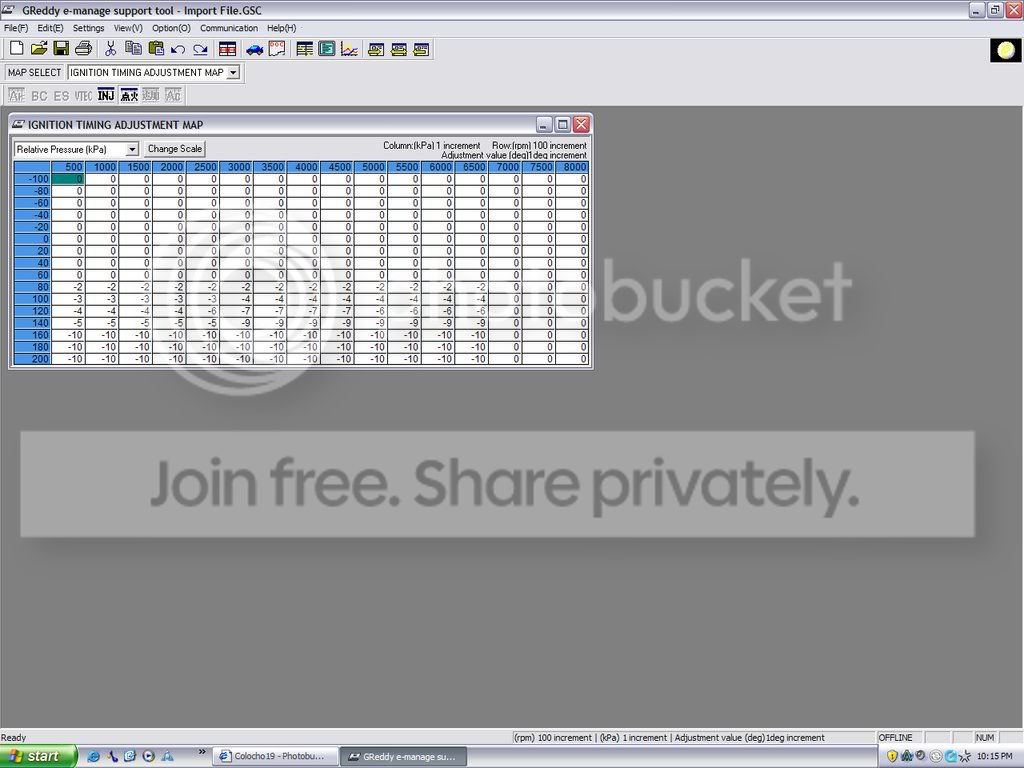

i have a map for 550cc injectors stage 1 kit tuned to 8.44psi. let me know.

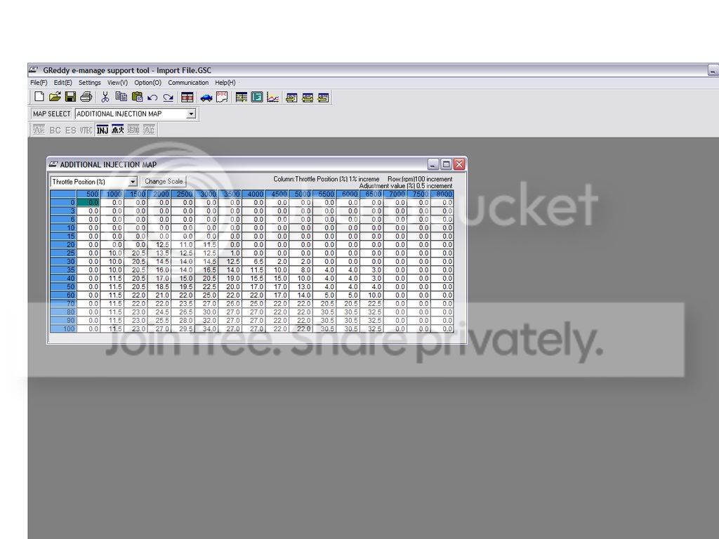

is this what you want?

but isnt that for a 20g?
Old Jun 24, 2008 | 02:16 PM
colocho19's Avatar
Posts: 60
From: Fairfax, VA USA
nah the car never got re-tuned after upgrading the turbo so this tune is for the 16g i had.
Old Jun 24, 2008 | 04:16 PM
chintastictc's Avatar
Posts: 1,049
From: Valley Stream, NY
noiceee...thanks alot what are the parameters set to....and if u email the map it would be alot easier i pmd u my email address you just have to attach the file

aww i tried putting the number in and realized ur using a MAP sensor which i dont have...man
