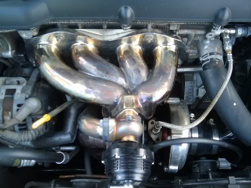

I was wondering if anyone knew what the max boost I can run on my tC. I have a turbo-kits.com turbo set up with a 3" downpipe back exhaust system. I currently am running 8lbs of boost. I have not got the car re-tuned yet since I got the new exhaust system.
Previous to the new exhaust the car had 230whp and 235 ft lbs tq with a Magnaflow cat back system. Im getting it tuned this week and was wondering if I should have them crank of up the boost or is the stock engine internals not designed to handle more than 8lbs of boost.
I'm hoping with the new exhaust that it bumps up the horsepower by 30 or more and it allows for more boost. Does anyone know what the max boost I can run with this new exhaust?
