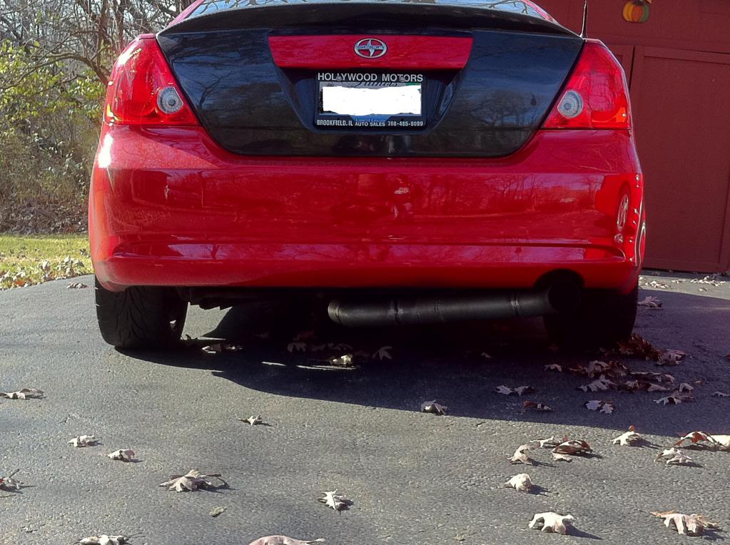

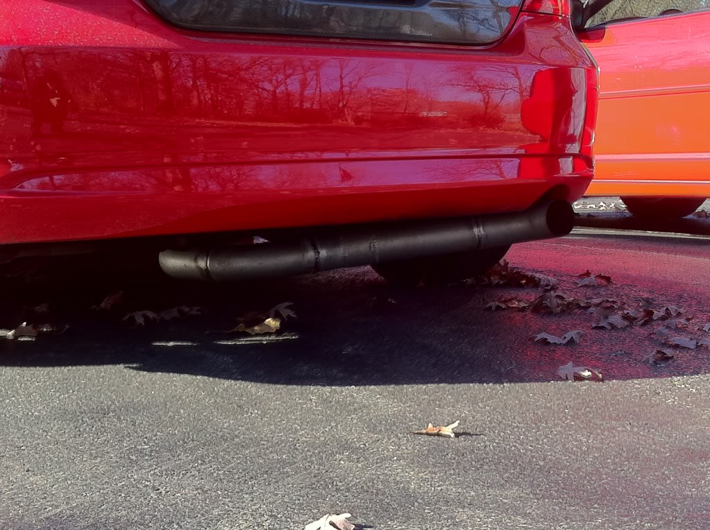

Originally Posted by Joyride
Yup thats true, im running s pipe only too, and that ____ smells like a mother, not only its loud as hell it smells too haha. It gets annoying after a while. Cant wait to pick up my exhaust next week
yes i agree but i got a little secret muffler im gonna build and show ya later i cant spoil it all at once lol... here are pics of my old exhaust set up went from 3" to a resonator off that to a 3 1/2 axle back just cause i dont like the big cans. and the smell of race fuel has been burnt into my head since i was a little kid i love it!!!!!
