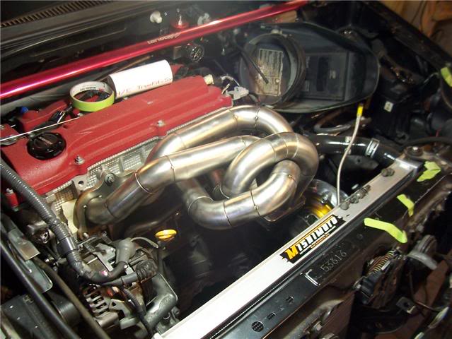

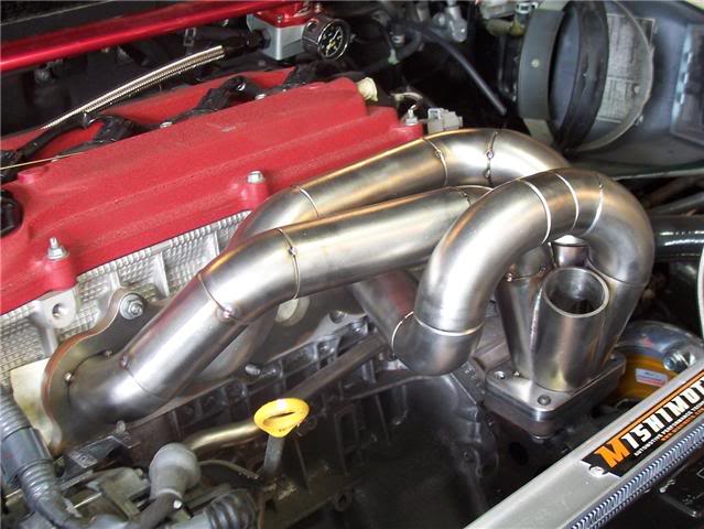

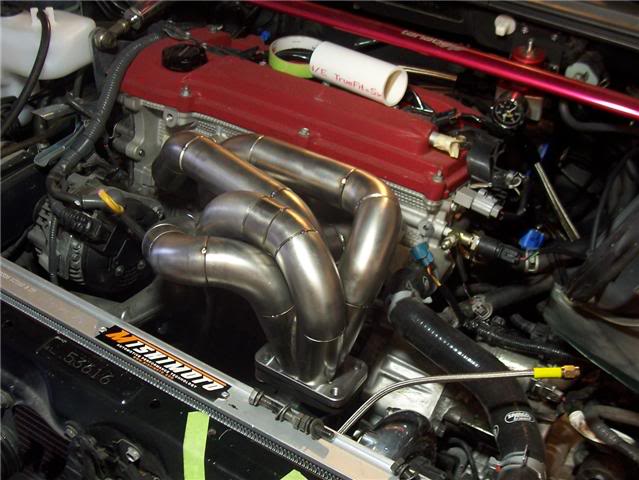

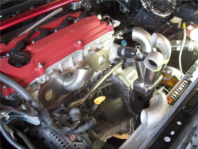

Let me know what you guys think.....

not to shabby.....what size pipes? and is it an equal length?

it looks a little haphazard but looks like youll have plenty of room for your downpipe...overall i like it. like to see how it performs.
doing this yourself? what are your goals?
1.5(id) .100 wall thickness, and its not equal but damn close.
my boy is doing this one for me because school is kicking my a$$ right now. Goals..... im shooting for somewhere around 4-500 whp.

Looks real good and unique. Looks kind of close to the fans. Hope you don't have much engine movement. Congrats! Numbers please

looks sick, you have enough room for a 4" downpipe, lol
where's the wastegate going to be located?

Awesome job
Where is the wastegate going to be mounted?

wastegate? doh forgot about making a flange for that...bahahaha

how much room between the compressor housing and slave cyl?

oh man he did forget the wastegate, oh boy now hes gotta do internal WG i like it so far...

Can't you do an elbow from the front of the collector towards the passenger side for the WG? Then you might be able to recirc it into the downpipe. If you don't wanna, you could easily make a dump tube in that area.
