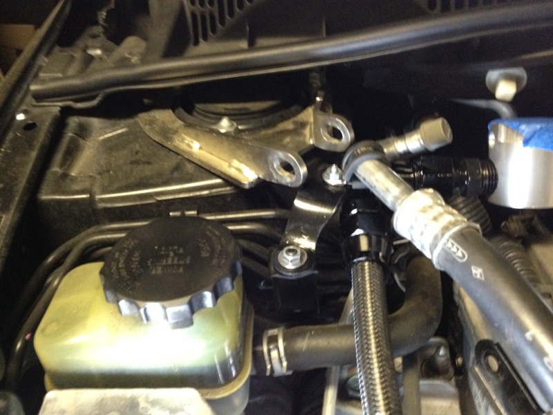

My intake tubing is off being welded and have everything wired up. Funny mistake, when I first wired up my pump I tapped the radiator fan lines so instead of the pump coming on the radiator fans kicked on. Have it wired into my AEM water injection switch so I can turn then off and on together. Made a bracket to seperate my AC line about the water line.
I may do the little bit of engine work I wanted to do before going and getting retuned. Will see how long it takes to get my intake tubing back.

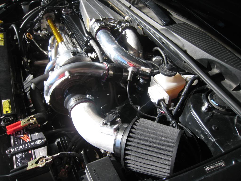

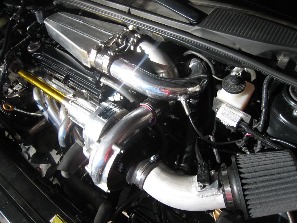

Small update, all the intake tubing is welded up so everything for the intercooler is done. I did yank the engine out for some head work so I am waiting on that now. I sent the header off to get coated as well while I am waiting on the head. Should be well into December before I can get tuned.

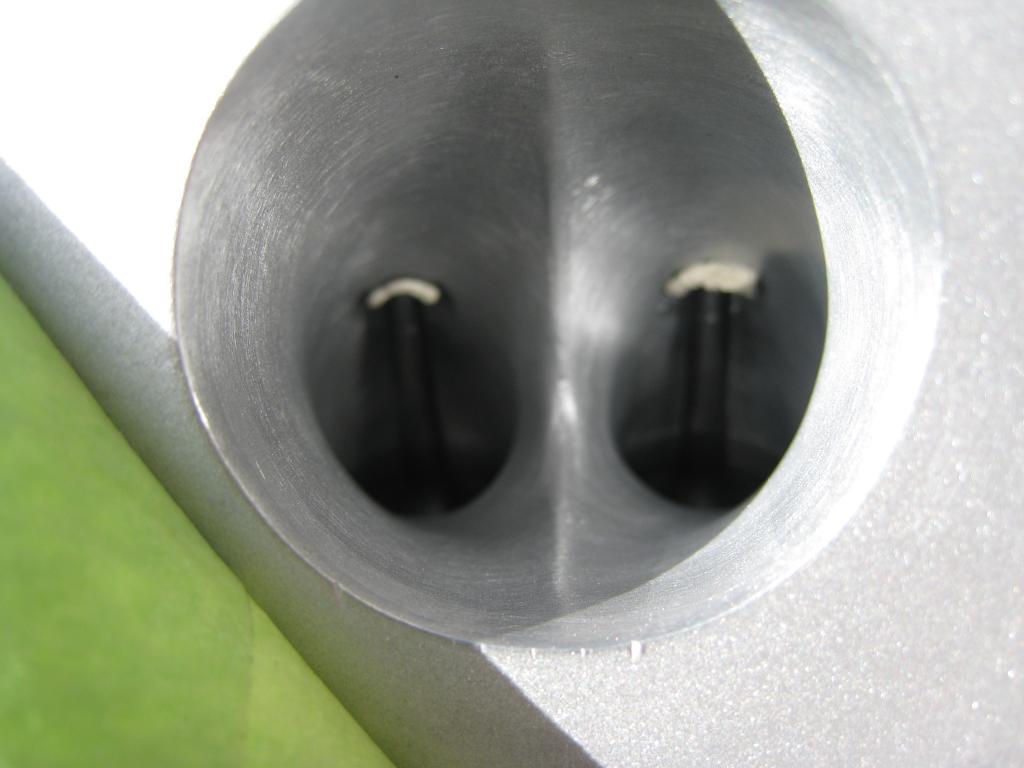

Update, turns out I was right that Toyota didn't put my engine back together correctly. They had installed my balance shafts out of the proper clocking so they were actually doing the opposite of their job. That is fixed now and did some head work at the same time. I also got my header coated during the down time but now everything is going back together. Goa is in 2 weeks to back at my tuner.
One piece of intake tubing is still be welded and once I have test run everything I will get everything powder coated.

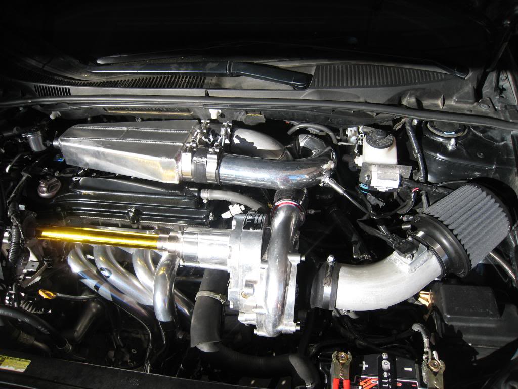

Everything is together and checking for leaks which most have been sorted now. I need to make an appointment with my tuner now and will have him break in my engine and tune it since my intake is now 3.5 in instead of 2.5 so the ecu is a little ____ed on the AFR at idle but it does run.

Dropped my car off and my tuner said I might have an issue with the larger throat at the MAF. So there is a possibility I may have to rework my intake some if he can't get a tune to stick or I run into drivability issues. Guess that is part of doing a custom setup, hopefully I didn't miss anything else big.
