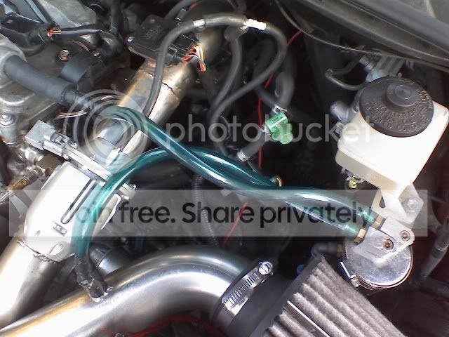

is a filter needed? 5W30 has a flashover point of 228 C. The valve chamber should be around the same temp as your engine coolant, around 83 C, so any oil going through the breather tube should still be liquid, though possibly in a mist. I would expect gravity to allow the oil to fall in the tank before the air goes out of the exit tube. The stock configuration on my xB has a straight hose running from the valve cover to the air intake with no filter in line. I was noticing some oil in the throttle body and ended up going with the Weapon R oil catch tank with my own mounting bracket fabricated. They do also make a tC specific version, about half the cost of the Greddy. they did come with the damned clear hoses, which I swapped with the solid grey that came with the intake.
Universal install on an xB:

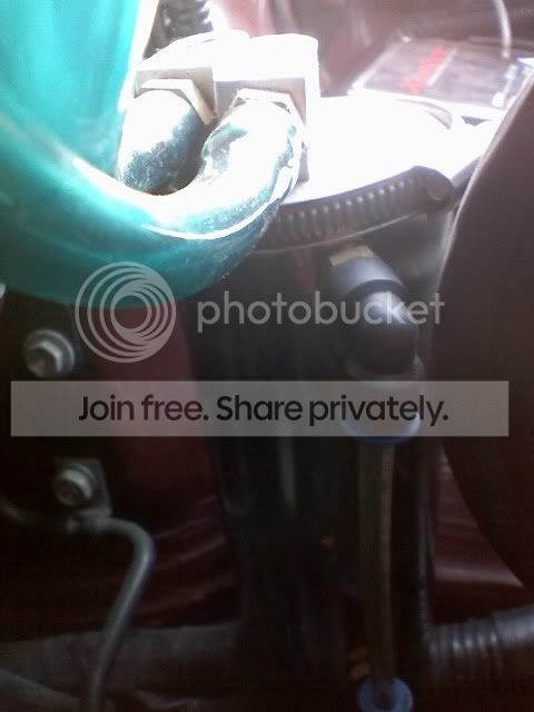

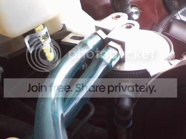

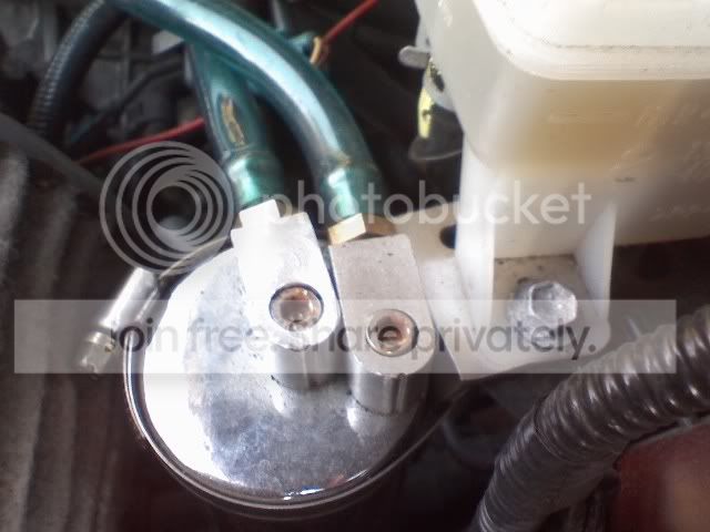

Here is just an Idea of how I did mine.... It came with brackets so I just used one of them and used an existing bolt.... You could always use a self tapper and mount it any where you wanted or build your own bracket using some sheet metal a good pliers a drill and some creativity.

Default !
i think im gonna mount mine like that....
