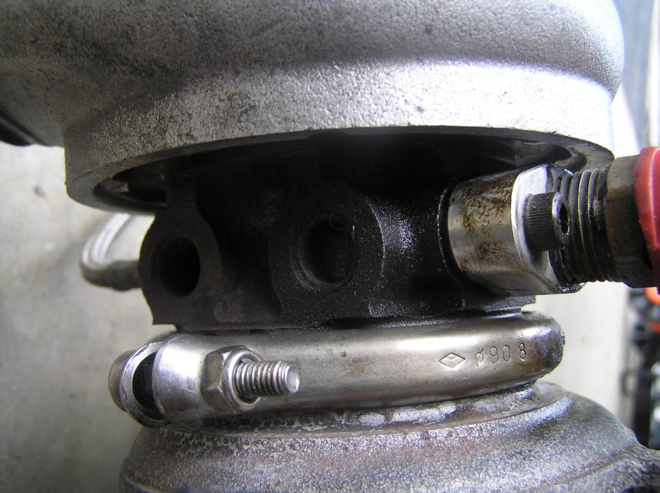

so im running a 2006 tc with a zpi stage 0 and i havent had any problems untill now. last week i was checking my oil and i noticed that there was oil all over the transmission and some of the engine and i thought i blew a head gasket but i took off the intake pipe from the turbo and there was a very tiny amount of oil and the bottom of the turbo near the oil drain line is covered in oil... the exhuast doesnt smoke and there is no shaft play on the turbo.... does anyone have an idea of what might be wrong?

Check the oil return line and make sure the gasket is not worn and is fitted properly.
How long have you had the turbo?
You can run a catch can to be safe.
Post some pics of where the oil leaks from if you can.

Yeah they were tight I'll pos a pic of the leak tomorrow
Old Jun 16, 2011 | 02:30 PM
tcrs20's Avatar
Joined: Nov 2010
Posts: 270
well thats the leak

ya man time for a new turbo.
