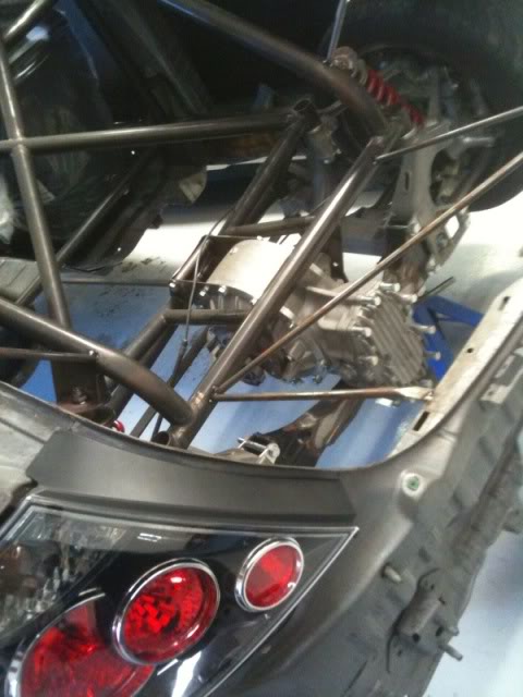

sneak peek on how intense the chassis building process is...

On that note, any tips for a hobbyist mechanic/racer and Program Manager in the IT field to become a fabricator/tuner too?
Thanks for the photos Rob, but I've got a couple quick questions. Why did you guys switch to smaller diameter tubing to connect the horizontal supports to the rear of the car? Weight savings? Won't be experiencing the same amount of torsional load/flex? Both? Other?
Love the way you've built the suspension cambered like that! Must be nice to be able to build the geometery design to your exact specs instead of having to move around stock setups.
You guys are insane and I love it.
That's a good question which I don't know the answer too. I'll ask the lead fabricator and get back to you.
IMO...they probably used the thinker / heavy wall tubing for support & the thinner tubing for structure. I might be totally off but either way I'll ask the experts tomorrow.
