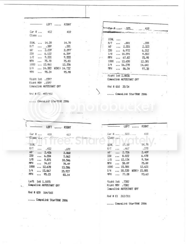

I'm ____ED!! I can't find my 14.3 run slip... i had it with all the others now it up and dissapeared... oh well.. these are my meth vs. no meth runs. im #410 ... top are w/ and bottom are w/out.

What kind of Tires were you using?
We was running 15.1 with nothing more than an exhaust back when the car was N/A'ed. Shaved a little weight, and running 15.1-15.2 in the 1/4.
I would imagine high 14's WITHOUT the meth/water inject on the S/C'er. You DESPARATELY need to work on those 60 foot times....2.8 60 foot, I don't think I have seen a 60 foot time that high.
Practice Young Grasshopper. And Don't DUMP the Clutch..

keep in mind that these are with a slipping clutch. 1-2 shift had to be nice and easy or the clutch will just glaze over. and you must have been looking at the wrong side of the slip cause my worse 60' was 2.426.
as for tires... bfg gforce sport. i had em laying around on my 18's and figured they would be better then my stock rubber. also those 18's arent the lightest wheel/tire combo so could shave some more time by lightening up the rolling mass.
again.. the point of this trip was to see the diff between meth and no meth. the cluch is going in monday and got some more goodies in the mail. my goal is 13's which i see happening in the next month or 2.
