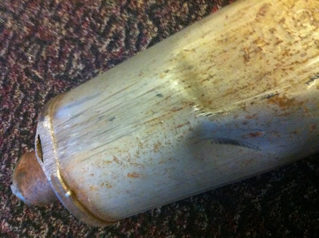

Got the resonator taken out just earlier today... sounds great
I took it home so I could snap some pics of the damage:
