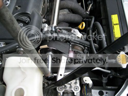

Take the belt off,
Then use a Strap Filter Wrench with some sandpapaer inside.
That was how i install the 9.5 pulley.

nice wrench, where did you get that fancy piece of engineering?
Old Jan 31, 2008 | 04:48 AM
GammaTNT's Avatar
iTrader: (8)
Posts: 2,592
From: NJ
pep boys and advance auto parts sell them
it is actually 2 tool . the strap filter wrench and belt tool.
