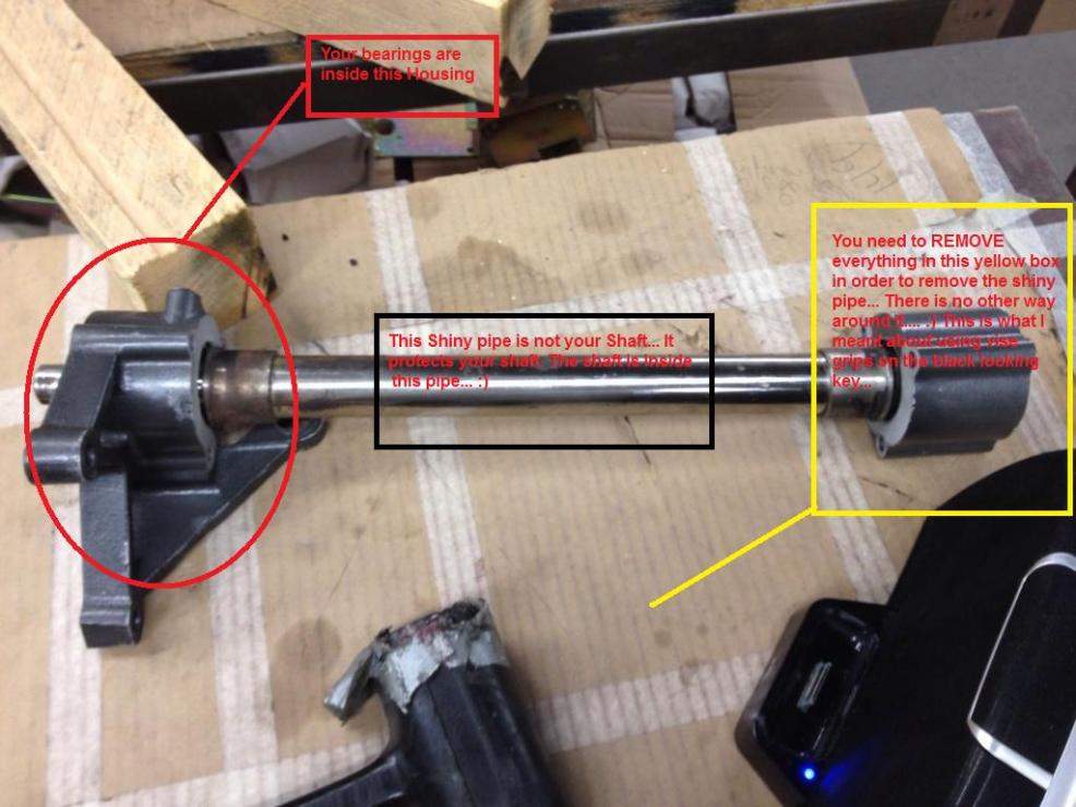

Stuck on what to do here's a pic

if youre banging it out with a hammer, then you have it upside down. flip it so that the long part of the shaft is what you're hitting...
please please be careful not to bend the shaft. otherwise you'll need a new one.
thats why a press is better because it basically uses force to push it out.

Nothing to hit on the other end heres what I got

  #70
JAY_NYCE's Avatar
Posts: 66
From: New Jersey
the actual shaft is inside of the shaft cover. you have to remove that. Also everything on the right side of your picture needs to come off... yes that stubborn bolt {12 point ferry cap} needs to come off.
Ive actually found that a 12 point bolt {i believe a 13mm} and vise grips work out for me. I take the vise grip and lock it on the 3 pin adapter key then I use a torque wrench and unscrew the bolt. works every time for me.

I'm
Lost dude how do I remove the shaft cover I just need to check the bearings

here is a pic...
Attached Thumbnails S/C pulley noise?-work.jpg

From: MA
Ok so I can't get to the bearings till I remove the bolt on the other end?
Old Aug 22, 2012 | 02:24 AM
  #74
JAY_NYCE's Avatar
Posts: 66
From: New Jersey
That is correct

did you really think TRD/Vortech would make it easy for us??? lol.. yeah right... You have to take it all apart just to get to the bearings... and once you change them out, you get to do this again next year... my advise... get a bearing press/all metric sockets/pulley remover and shave off hours and hours of labor..
