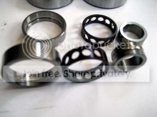

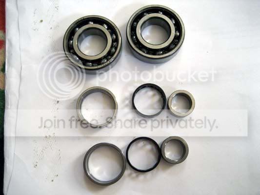

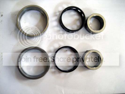

Just got new bearings and seal replaced by Ptuning. This is why my sc is making whining noise: The smaller bearings are in pieces!
I want to thank Kikcaffine for the bearings and seal.
And thanks to Ptuning, they did a great job rebuilt the sc. They even fixed my AC wire. The metal bracket above the SC pulley been rubbing on it. and cause it to blew a fuse.
