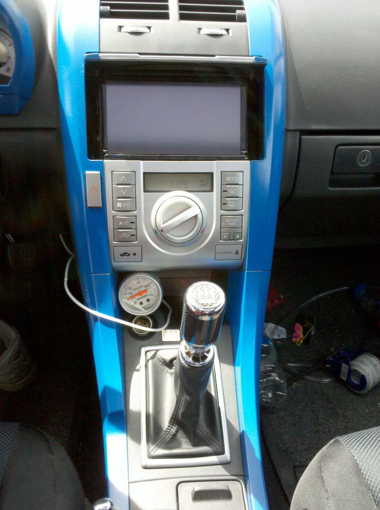

The first "mod" that i did was to put in some 8k HID's and some blue LEDs as well to give it even more of a blue look. along with that i put in a blue cubby hole light.
after that i bought myself a JVC-KW-ADV792 head unit. I love it! I have the ipod cable routed to the glove box so it can stay plugged in at all times. You use the headunit to control the ipod so it being in glove box makes no difference to me. I also grounded the ebrake so people can watch movies in it. My main intention for that was i was goign to be driving to new york which would have been a boring drive for the passengers.

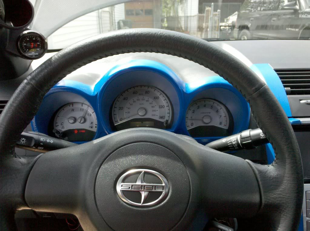

back to looks a little bit, I decided i would do a guage and HVAC led swap. I did it myself, and it turned out about 90% good.
My left turn signal doesn't light up anymore and the Mode, and front and rear defrost buttons on the HVAC don't light up white. the odo led is reversed a little bit, it's white/clear background with blue numbers. I didn't like it at first, but haven't seen anyone else with it and i've grown to like it! The LED for the time on the HVAC is still orange ebcause i haven't been able to find someone that can get it off for me

Another step towards going turbo, I installed my AEM guages on a triple pod A-pillar. Boost, AFR, and oil pressure all digital. Along with the install of these i needed a new S-pipe for the 2nd bung for the UEGO. So a CC s-pipe was installed.

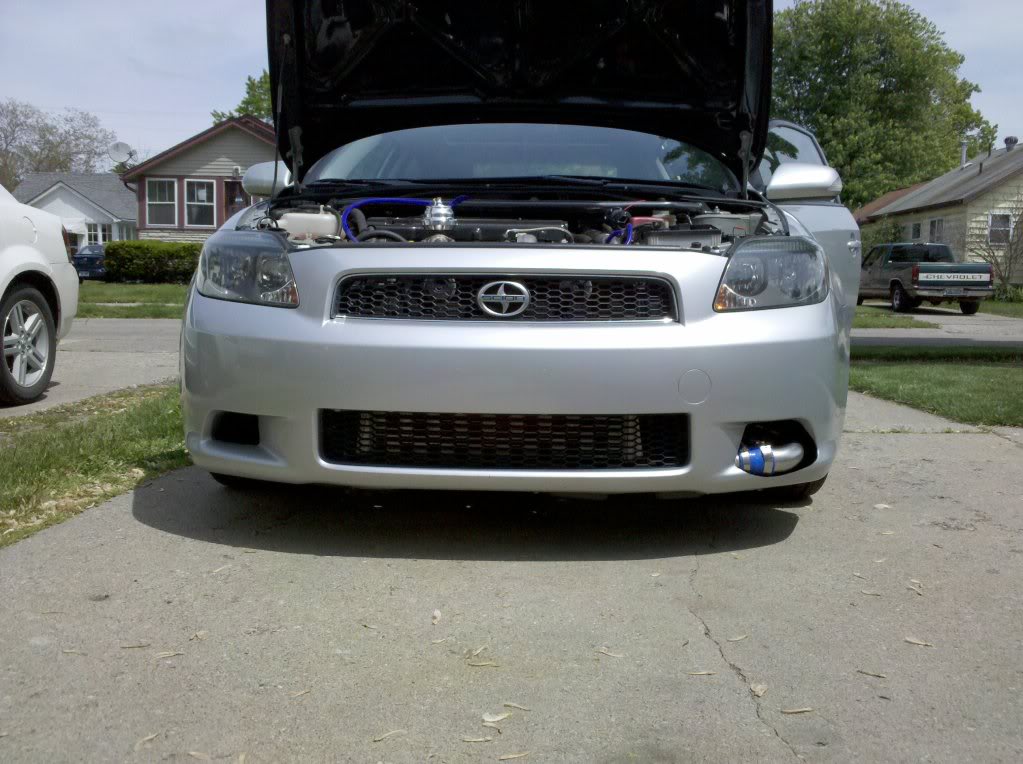

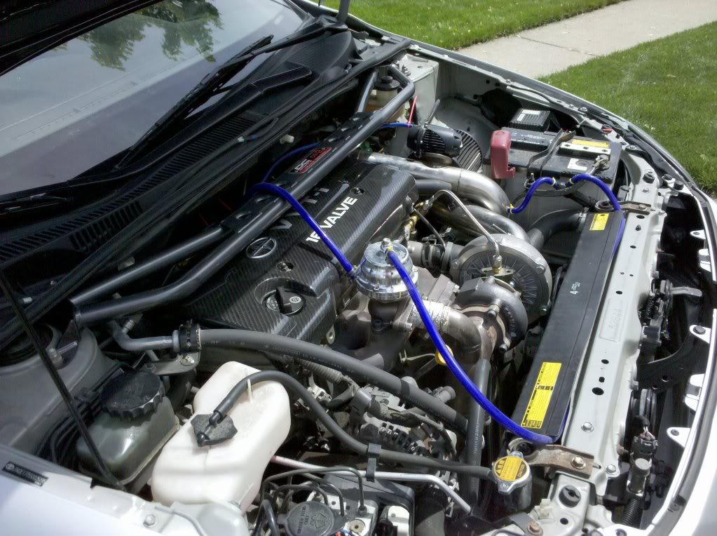

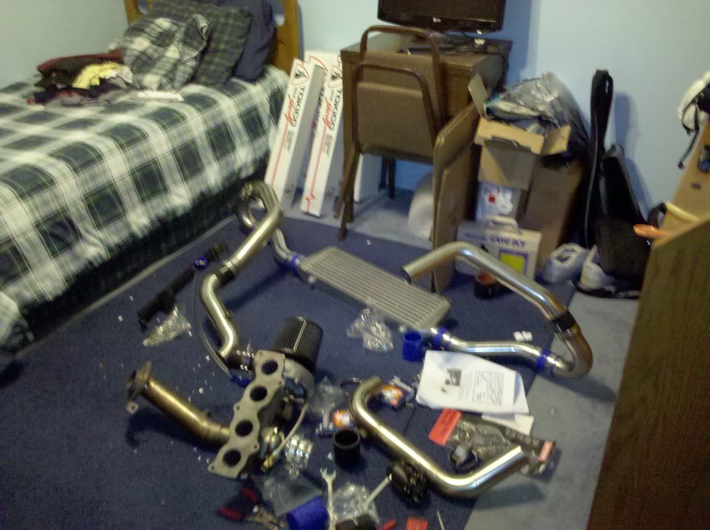

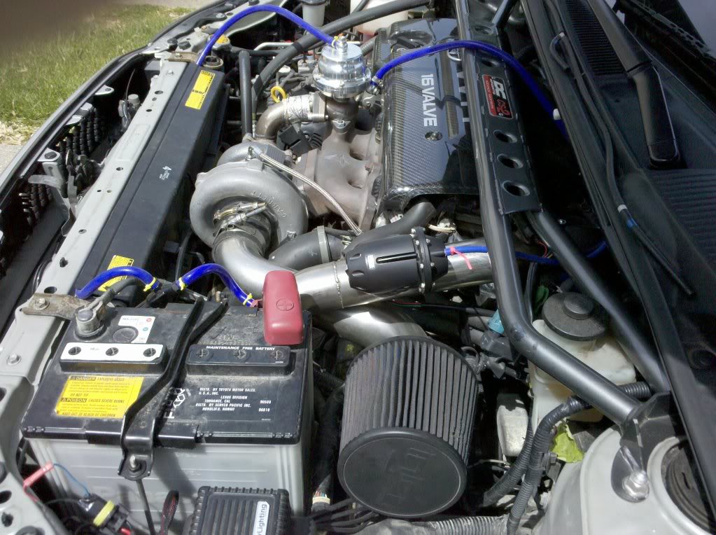

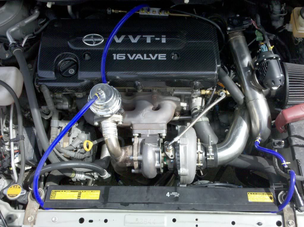

Turbo was installed and partially tuned. finished almost all of it in one night! The intercooler piping was the hardest part. Had to cut my bumper a little bit. It looks good to me though! also got a carbon fiber valve cover.

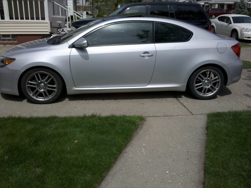

tokico blue's struts, with tien h-tech's were put on. dropped it down perfectly! i love the way it looks now.

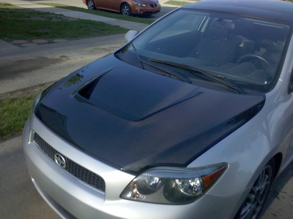

got my kaminari carbon fiber reverse cowl hood installed. Would have been done yesterday but could get the hood to latch closed.

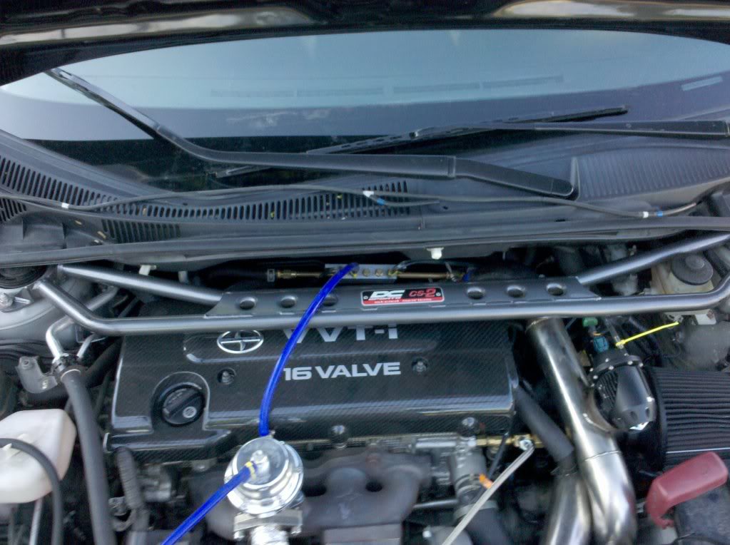

DC strut bar came in the mail, and was on 10 minutes later!

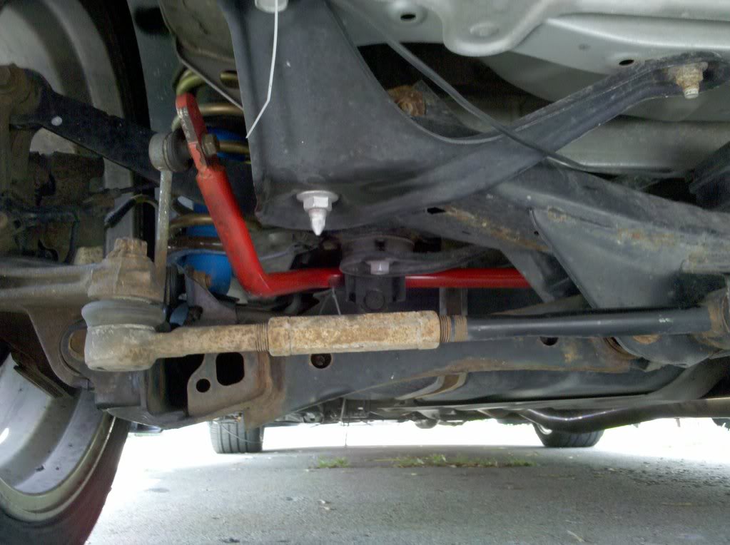

and then the sway

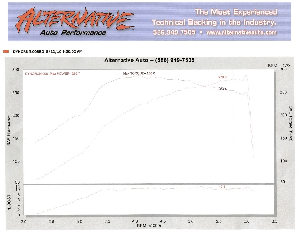

took the car to alternative motorsports and had my car tuned by dan the tuning guru, along with an xA and bens tc. me and the xA went pretty good! bens... not so much though here's my sheet though!!!

Turbo - T3/T4 .57 Trim .63 A/R
intercooler - greddy
BOV - HKS SSQV Black
Wastegate -Tial 38mm
Manifold - Turbonetics
Downpipe - Turbonetics
IC Piping - Dezod
Injectors - 625cc Ptuning
Oil Pressure/return line - Dezod
Fuel Management - AEM FIC
