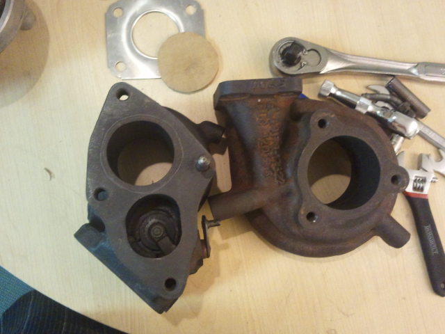

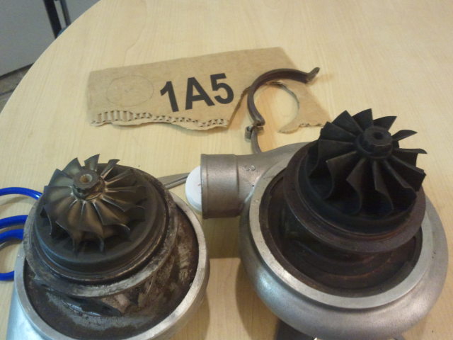

ok so hopefully this will be my last turbo post. but ive been researching like crazy and i cant seem to get some answers. and the ones that i have gotten i would love to get some opinions.
first off. im running the zpi manifold which uses the mitsubishi flange and...well its been a huge hassle. well i as you all know by my other posts ive been on the search for a new turbo. well ive been trying to be a little bit different and just stick with the dsm flange rather than getting a t3.
so right now i have a 20g turbo. but i have honestly no clue what size the turbine wheel is and i dont know how to measure it. but i measured it across the downpipe flange and it was around 6.2cm, but the turbine is still huge compared to my 16g which has a 7cm and my 14b which had a 6cm. the pictures are compared to the 14b seeing as the 16g is still on my car lol. well not that you guys can tell from the pictures. but if you would have to guess, what size do you think it could be?
ok well heres where the problem comes in. i have a 4 bolt down pipe and a mitsu flange. and the turbo i want to run(the 20g) has a 3 bolt down pipe flange and a twin scroll. well the 16g exhaust side will fit on the 20g if it is possible to port the 7cm 16g into whatever size turbine wheel that is. so is it possible to port the exhaust side? i think its only around a 3mm difference but im not 100%
so that leaves me with a few options that might and might not be feasable. so my main questions i guess would be. should i just get a t3 flange welded on and a new downpipe? but my only concern about the 20g turbine side is, is that im not sure if its going to be too large? i mean im looking for a decent amount of tq still. i dont want to only have the last 1500rpm's on my powerband..lol, or is the twin scroll that efficient?
or should i try the port job on the 16g turbine housing seeing as that will probably be the cheapest and the most efficient turbo set up (in my opinion, although i very well could be wrong lol). and is the porting even possible?
and the last option would be to just take the compressor wheel/cover off and rebuild my 16g with it on there?
im really sorry about the rediculous post. its late and i started to babble on a lot..well just throw out any opinions you have. im just trying to make a different set up that from what i know of. no one has. lol thanks guys!

Call Greddy USA about the 20g turbine size
You need to contact a machine shop about porting the turbine side. I'm famaliar with people porting the comp side for better velocity and spool but hot side not so much.
As for the other issues I say just rebuild the 16g and run with it for now and later deal with building/changing the wheels and housing that is unless you have second car to drive and can the TC down while you fix the turbo to your taste.

yeah im familiar with porting the comp side too, i was just curious weather it is possible to port the turbine side. it seems possible but im guessing its probably not very practical.
and yep. as of now i think im just going to go online and get arebuild and a 20g compressor wheel and housing and throw that on my 16g then just get that balanced and have a td05 20g =)

I had the 20G compressor, but my turbine side was the same as the 16G. Actually I think it actually was a 16/20G that I have running a while back.

Not bad. Better top end, spool was pretty much the same. Not sure on the power, but I was running it on 12lbs. I enjoyed it. Ideal for a street setup.
