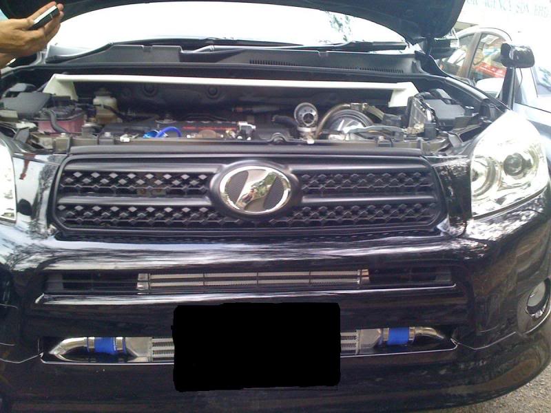

ya, 3rd gen Rav4 same engine with scion tc, just set it with 7psi, thinking to up 9psi, upgrade the fuel system, and maybe change turbo.

dude im not gonna lie thats kinda neat...definetly one of a kind...
