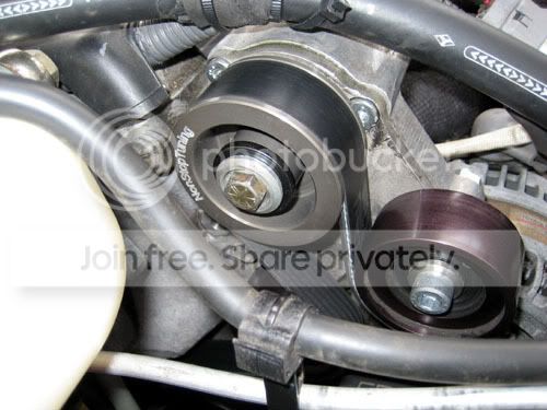

i just received NST pulley. Can someone tell me how to remove the stock sc pulley?
The bolt keep turning when i try to take it off.
edit: removed with strap wrench with some Sand paper inside. I folded the sand paper so the rough part is on both side. My buddy wrap the strap wrench very tight. and it holds!!!
Took me 3 tries. Glad it come off on the last try, because i almost give up. If you didn't get it grip the first time. Just keep trying,
