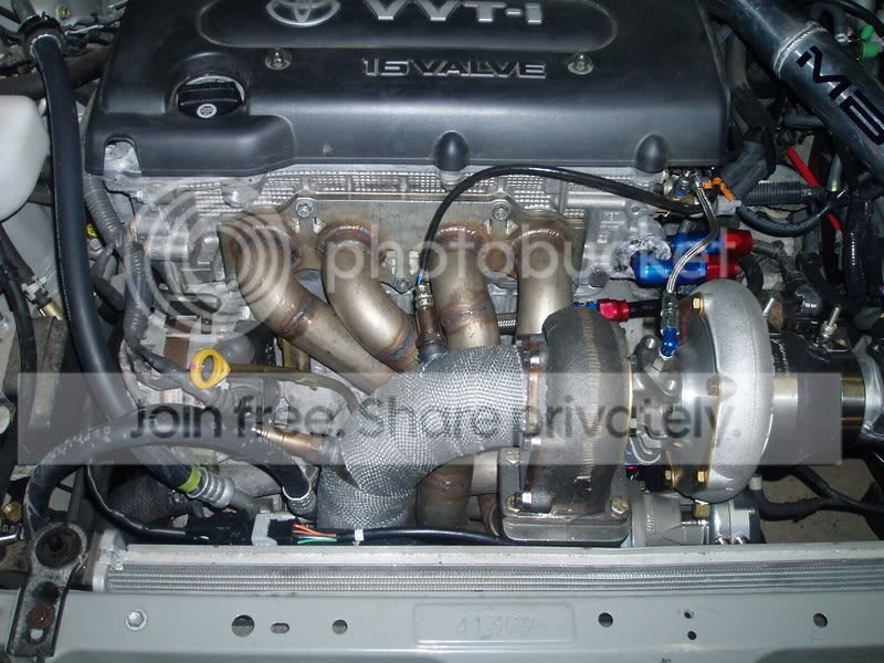

my project is almost end, sneak pre-view to everyone

toyotaracer9's Avatar
Posts: 301
From: new orleans La.
looks very nice and neat . what kind of power are u lookin for ? I dont know how true it is but I hear the MAF sensor give unstable readings that close to the impeller .
Old Dec 10, 2006 | 03:34 AM
calvinwch's Avatar
Posts: 339
donno about the #'s yet, will have it on the dyno when i have chance some day.
But we take a estiamte of that should making anywhere around 300whp at 7lbs.
for the MAF, most of my part has been change. That i belive will have no problem with the MAF. The car has just partialy tuned today, which the MAF has been set. Only the problem is the Greedy eManager for the throttle body control. Tunner is reading flat line when try to tune it, I know that if using the plug & play wire the problem will go away, but i don't feel why have spend another 300 bucks for the stuff that greedy sell has bugs. once again Greedy

300whp at 7lbs that would be great , what r the turbo specs?

I will post more tech. spec later on when the car is done(sometime on the coming week) Beside the fuel managerment and the BOV turob etc... mainfold and all the piping is custom made.

You will need a fairly large turbine to get 300whp @ 7lbs. On a GT30R I've seen 330whp on 9lbs, so I assume you are running a similar sized turbine.

Looks like a large to4s compressor housing with 4" inlet.. if it is a gt series it is either a 3071 or 3076.. but the turbine housing is confusing.. looks to be a centered turbine housing which is not so hot of an item... mabey it is just an optical illusion.. good luck with your 300whp at 7 psi Let us know how it turns out!

i have precision turbo sc61, which i belive it is bigger than the gt30r. I will release all the detail later on when i get my car sometime this week.

large to4e compressor housing with 4" inlet.. if it is a gt series it is either a 3071 or 3076.. but the turbine housing is confusing.. looks to be a centered turbine housing which is not so hot of an item... mabey it is just an optical illusion.. good luck with your 300whp at 7 psi Let us know how it turns out!
just don't forgot that not only turbo making the HP, my custom made = lenght header is adding HP + custom from header all the way to the exhuast. and the custom piping for all the cooling and intake. Even i got the Greedy emanager tune, the stock map is suck.
Just my setup i didn't want to risk to boost up double digi, so just running 7lbs as now. Too bad that at first gear the stock clutch already slip when boost, stage 4 clutch and fly wheel is going to be install on coming week

Here is a clear pic of the setup, should be pickup my tC on this Wensday or Thursday.

Check out the upper radiator hose connection -It's gone! OMG, how are you getting water into the block? I see a AN type fitting in it's place - but it looks too small, it's easily a third the size of the stock radiator hose. Who ever custom made this turbo has some big brass "@#@$"! I hope it works good.
