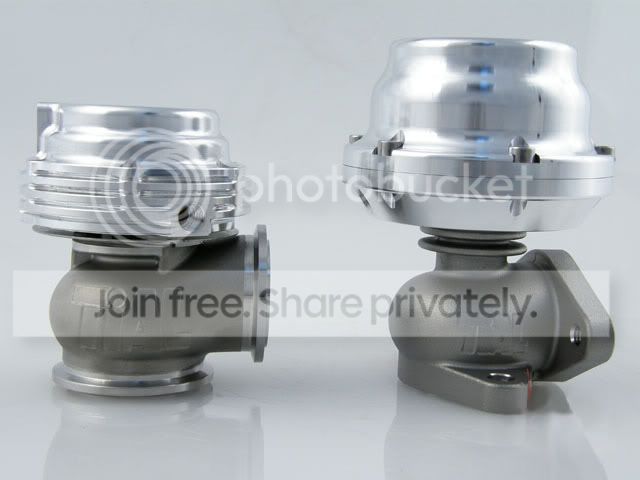

Anyone used it yet?
I need something a bit shorter than the T'netics wastegate.

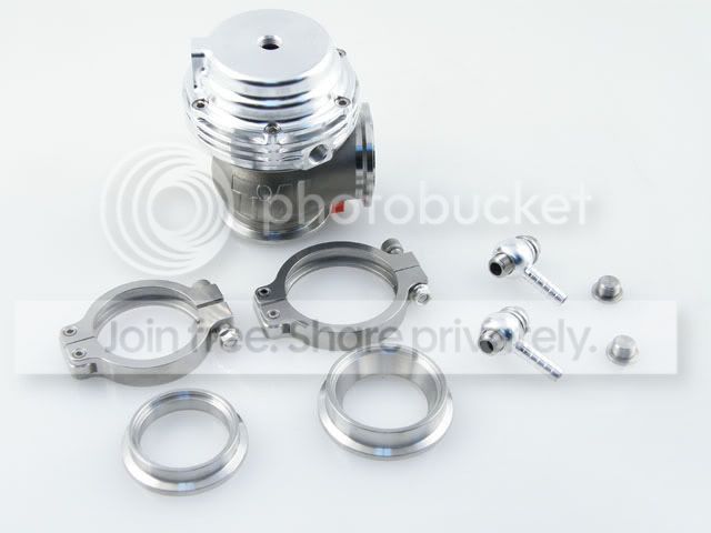

- High temp NiCrFe based alloy is used for valve and 347SS valve housing will offer longer product life compared to competing designs.
- High temperature silicone Nomex reinforced actuator diaphragm.
- 17-7 PH Stainless Steel actuator spring gives consistent pressure at high temperature, resist "relaxing" at temperature to 900F (483C).
- Nitronic 60 Stainless Steel is used for the valve seat, and valve bushing.
- All Stainless Steel hardware.
- Mating weld flanges are 304L
- Color anodized aluminum actuator (Silver, Red, Blue, Purple, Black).
- 3 lower ports and two top ports for easy install, no need to rotate the actuator top at all, plugs included for unused ports.
-Ultra compact design fits in very tight spaces, the unit stands only 3.7" tall, more compact than any other external wastegate on the market today.
- V-Band inlet and outlet make install easy, flanges and clamps are in the box!

The one with the T'netics kit seems like it's a foot tall.
After talking with Crush, he can weld an adapter to fit the T'netics kit.

tnetics have a deltagate flange right like the old tial 38mm? I just bought an adapter to make this fit so i dont have to weld on the manifold its gonna make it like 1-2cm taller though

Compared to the old height of the T'netics wg, 2cm can be absorbed before the max allowable height I need to stay within.

Why not just have an L-shaped adapter to relocate the wastegate a little? This way you won't be spending $240 + $xx on fabing to get this Tial to work? The wastegate won't give you any better performance so that money is probably best spent elsewhere.

Because I don't want to have to have my dump pipe taken off and remade/repositioned.
With this, it will mostly likely bolt up to the dump pipe... hopefully.

it comes with two vbands and 2 v band flanges?

its inlet is v band and the outlet is v-band!

^^ you happen to know the size of the outlet vband? is it like 1.7"?

Not sure what ever a 38mm flange would figure out to

38mm is close to 1.5"
