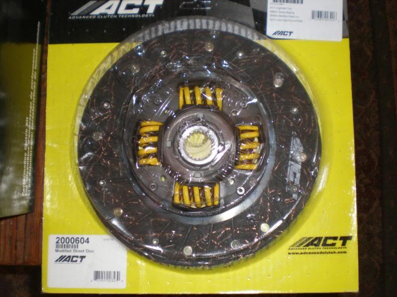

So today i purchased an ACT street disc for the scion tC. Which i must say i got a killer deal on. i picked it up for 400 bucks at a local shop here. I also got some redline MT-90 gear oil. now my owners manual is in my car, and my car happens to be at my friends house where we are doing the clutch. can i get somone to confirm for me that 75W90 is the correct weight for our trannies. i did some google searching and well i trust the folks on here more then the other answers i found.
Assuming weather holds up i should be putting miles on my clutch tomorrow evening.
pics of the destroyed clutch tomorrow or monday.
Again i want to thank the guys over at dezod for helping me figure this problem out over the phone.
