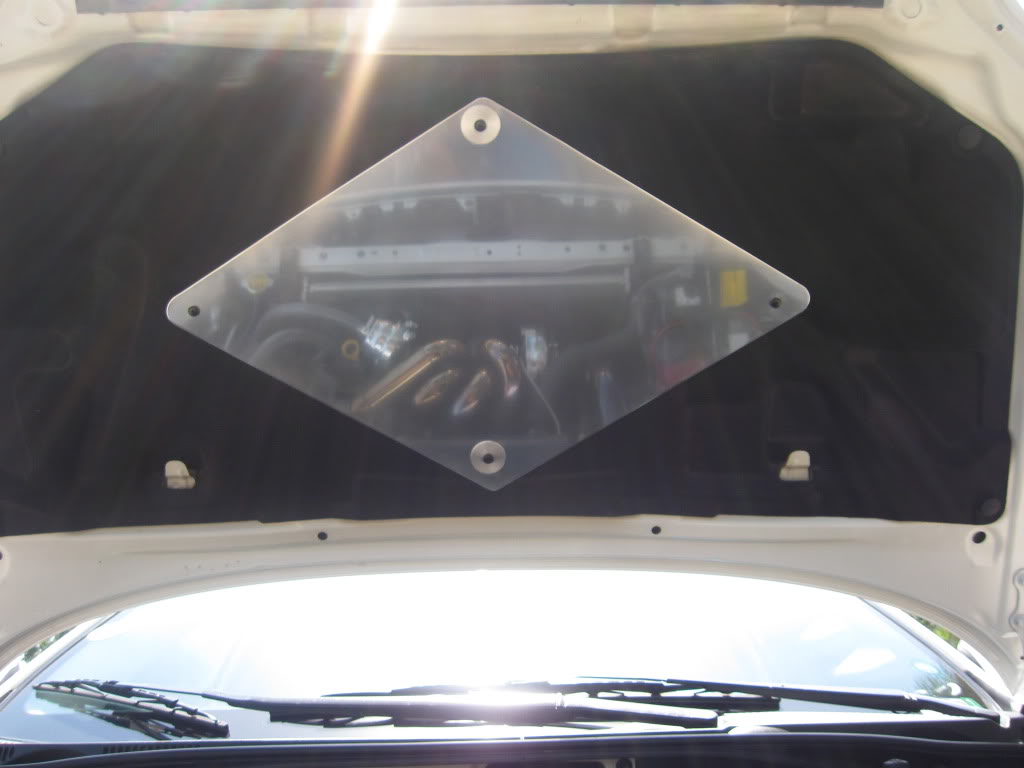

this could help if you want to cover up an ugly burnt spot and keep it from burning again

I dont make them anymore...i was just giving you an idea of what you could do..I may have one laying around but ill have to check in the morn
Old Feb 26, 2010 | 12:58 AM
crush02342002's Avatar
Posts: 11,271
btw thats not my car, thats carlos's aka carlanga. I started making those things because of him, his manifold comes close to the hood and the kit normaly comes with a stick on gold foil but he got the kit used so no foil. I took one look and came up with an idea of cutting some aluminum sheet metal and polishing em up to help reflect some of that heat and help spread the heat instead of it concentration on one spot. It worked like a charm and looks good too.
