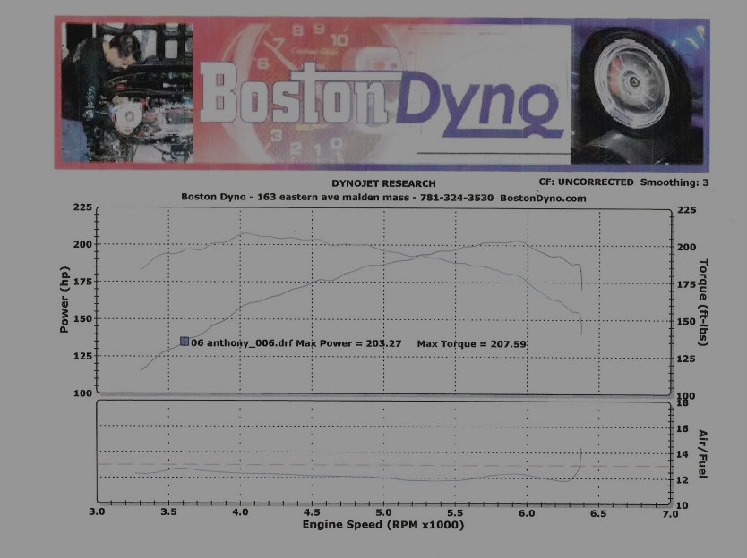

so i got my setup tuned im posting dyno sheet i have a 5-6psi spring in there but im only hitting 4.6psi i did 205whp what do you guys think??? also run was done in 3rd gear
well on the way home, my car starts dying on the road running SUPER SUPER rich cruise at 12afr, wot at <10afr, he tuned the carfor 12.2afr at wot on 550cc injectors, lt me know whats up

im goin back for a 9psi tune but i need to fix my spipe which crunches to about 2 in from 2.5 from bottoming out, also need a boost controller...

a couple of things to be worried about bro...one why are you only hitting 4.6psi i have the stage 0 in currently and i have the tial 5.8psi spring n i hit and hold 5.3psi at full boost no prob you might wanna check for vac/boost leaks anywhere. another thing is 203whp with a 5psi tune on 550cc injectors idk bro seems a lil low on power to me but im just saying

well the tuner had a stock tc with just headers and it put down 148whp im at 4.6psi and got 60+hp at under 5lb..... 1lb=12.39hp im pretty sure thats good as rule of thumb is 1lb=10hp

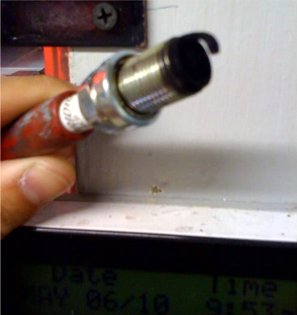

those plugs look fried!!!! lol

his hp is actually pretty spot on considering how rich he is running. if they lean it out a bit then he should see a hp gain.
why the hell is your cruise set at 12afr? that might cause the random shutting down!
to a vac block by the firewall

Did he tune for drivability or just WOT? If you have a huge FMIC then your boost will decrease, especially with a small turbo. If you have the capability, run the WG line to the compressor housing, if not, the vac block works.
Definitely get new plugs. I run the NGK Iridium IX's and they are fantastic.

thats what i used to have 1 step colder ngk iridium, now im back to ngk iridiums untill i order a new set
