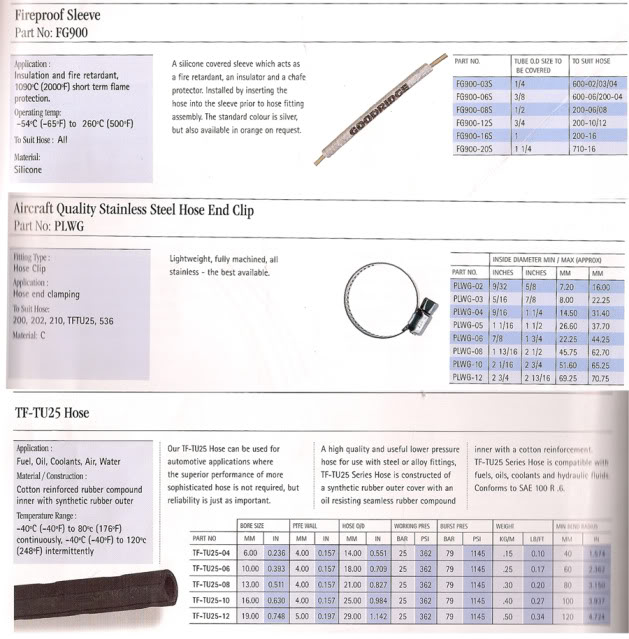

The oil lines you refer to are all made by GOODRIDGE and come with a life-time warranty for DESCENDANT customers. None of the other kits mention come with that!
Here is a section from the GOODRIDGE catalog where they give the description for the components included.
For those of you who don't know who GOODRIDGE is they are one of the leaders in AN-Plumping for the Race Car & Aerospace Industries. Check out their website at: www.goodridge.net

i didnt mean to make it sound like i was slamming your kit. i just mean my personal preference is tbolt clamps SS braided lines and a different diverter valve. im sorry i offened you rob i was just giving my opinion to answer the OP's question.

I feel the same way about wormdrive clamps...not a fan of em...seen many many SS wormdrives strip out. Not saying that these will cause I dont beleave i have used that specific brand, so i really couldnt judge. If it works it works!

the one thing i think people mess up with the t-bolt clamps is that an eager person could potentially end up crushing there i/c tubing if they are not careful. I've seen it happen many times. Oh and by the way i haven't had any problems with my Bosch bpv but i'll make sure to let everyone know if something happens.
