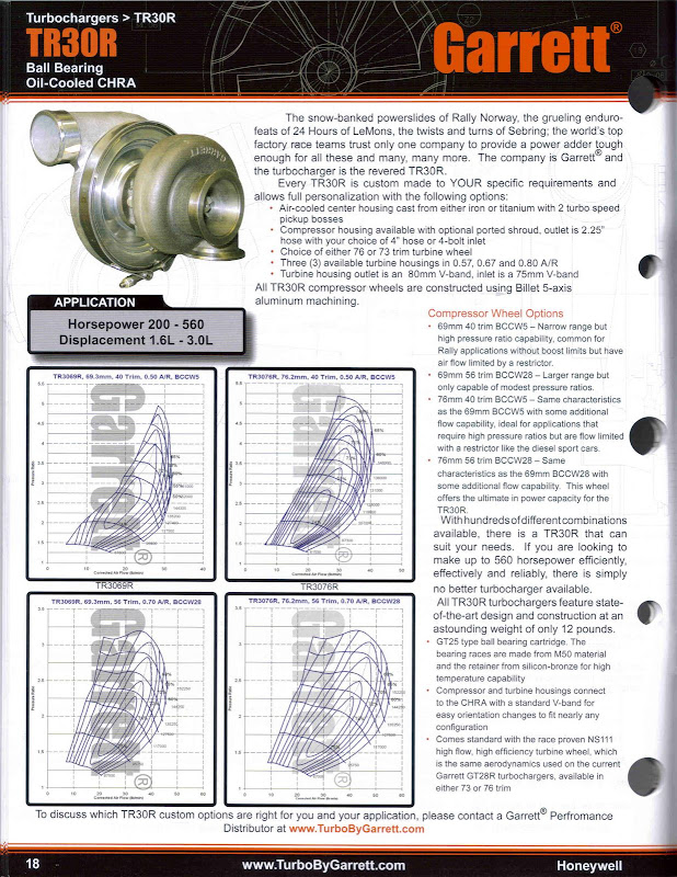

I want a good spool, and power all the way through the power band. I don't want to wait and have it spool late and be practically uncontrollable, but at the same time I don't want something too small (such as the 16g or the GT28RS disco) and have it run out of steam on the top end. I am asking because I am curious as to if this is the turbo/setup for me. The GT3071r looks pretty good too, but I imagine the GT2876r is more efficient and has better spool = better low end. At the same time, getting a .86 A/R turbine will give me more top end power, because I will have more flow essentially. I also can't believe that this GT2876r turbo is what the WRC turbo is based off of in a way. Check this out! If it is a similar efficient setup to that, then I am sold. I heard the only difference was that the gt28 turbine wheel is smaller.
http://lh4.ggpht.com/rdmtsjr/R5YvXiD...0R_Catalog.jpg
I know I know, I have been researching too much. But I want a turbo that can do everything I want now, and be able to give me more power (450ish) in the future. I figured the turbo I listed mated with a TiAL housing would be about perfect.
