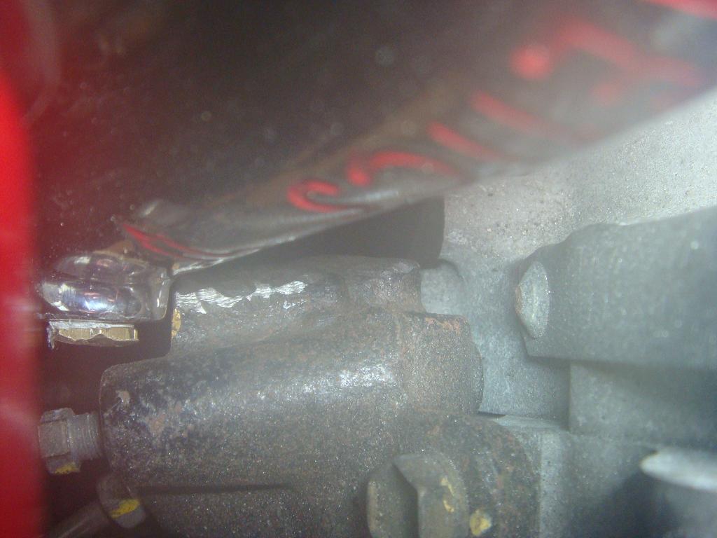

here is the issue with the clutch assembly interfering with the turbo housing. As you can see by position of the tube it is at the point where it cannot be clocked any more "counter clockwise" based on view of pics. It would obviously strike just the same, just a slight amount lower on the steel assembly...(not to mention at this point the charge pipe is 5/8" from contacting the DownPipe) and cannot be clocked any more "clockwise" due to clearance issues with the fan housing and charge pipe 90 degree tube adapter.

He got the wrong 90 degree coupler and that has been causing all of the issues with the clutch cylinder. The one he is using has longer legs and a longer radius, therefore the turbo needs to be clocked back further for the IC pipe to clear the fan. The short leg, tight radius coupler the kit was developed with should solve everything. Stupid overlook on our end, we are OVERNIGHT shipping him the correct coupler today.
Here is a picture of the development car. As you can see, plenty of clearance.
TO BE CLEAR turbokits.com HAS BEEN in contact with me and are trying (from what i can tell over the phone) to rectify/clarify these issues that i am running into.
frustrated yet optimistic
