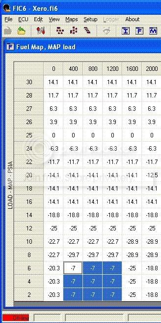

OK, in the following pic, you can see the 9 blue cells I have highlighted (actually 8 but that top one is currently selected)
The center one (4psia x 800rpm) is where my car sits at idle. all those cells have -7 in them, which means I am pulling 7% fuel from my injectors.
If your running lean at idle, you need to add more fuel in whatever cell is highlighted at idle.
If your running rich, you need to pull fuel (larger negative number)
DON'T FORGET THE NEGATIVE IF YOU'RE PULLING!

Oh, and one more thing...be SURE to make a backup copy of your maps from windows, NOT from withing the F/IC software, BEFORE you make any changes because the changes are saved as soon as you make them.
I have a folder with all my maps that are ReadOnly, and then another copy of them writable which are the ones I work on.

nope...just load the map, connect to the FIC and choose "from F/IC"
Then make whatever changes you need. Just be sure to save a backup of all yoru maps first.
