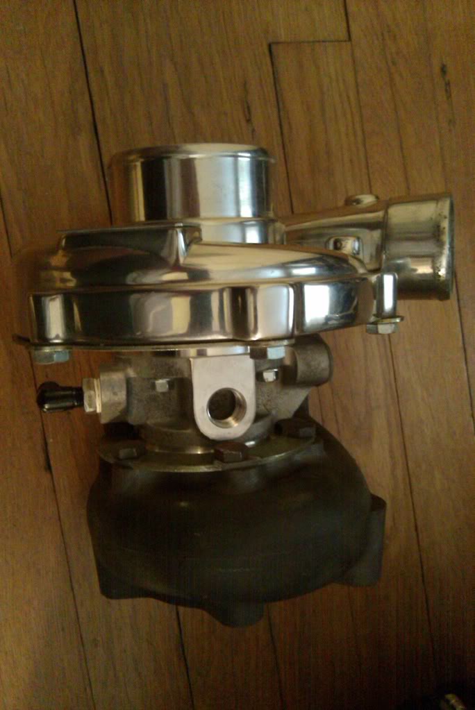

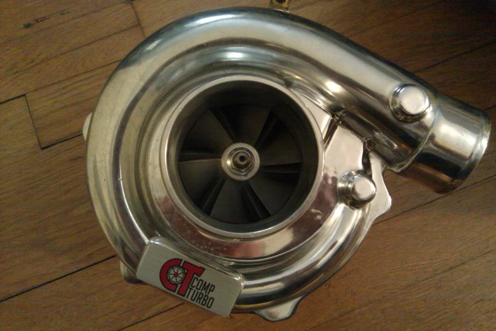

Well thanks to TOFAST4U (Justin Chirico) I now have a Comp Turbo TBB turbo.
Ok this turbo is water and oil cooled. I haven't had a water cooled turbo before so I have a few questions. First off does anyone know what size fittings I need to tap into the water lines? How long do the water lines need to be to reach the turbo? (I have the turbonetics manifold). Also is there and in side for the water line and and out side for the water line on the turbo?

flow direction doesnt matter, use 3/8" lines fed from the lines that go to the throttle body, remove those lines and put the new lines where the old ones went on the block. i think you need banjo fitting, check ATP turbo, possibly 14mm? cant remember at the moment. most of them are a standard size across the different turbo manufacturers.

I think there is a write up on Turbonetic's site. They also sell the fittings and line (Jegs.com would be cheaper though).

I bought mines from dezod. Just ask them that you only need the water line kit.
