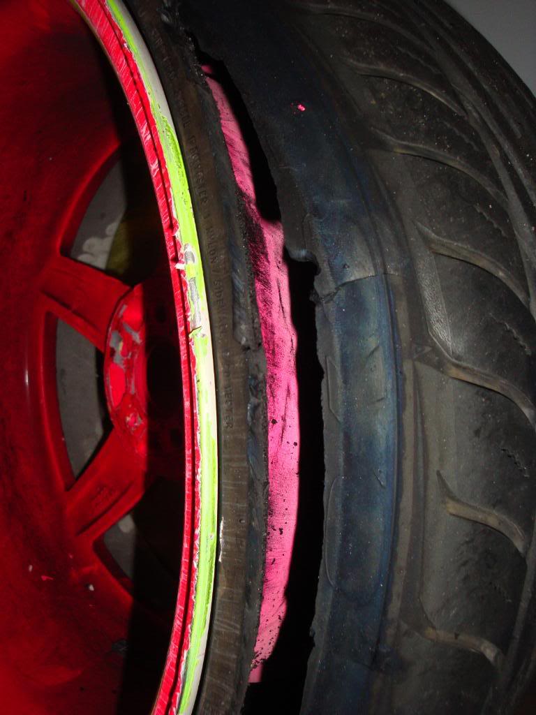

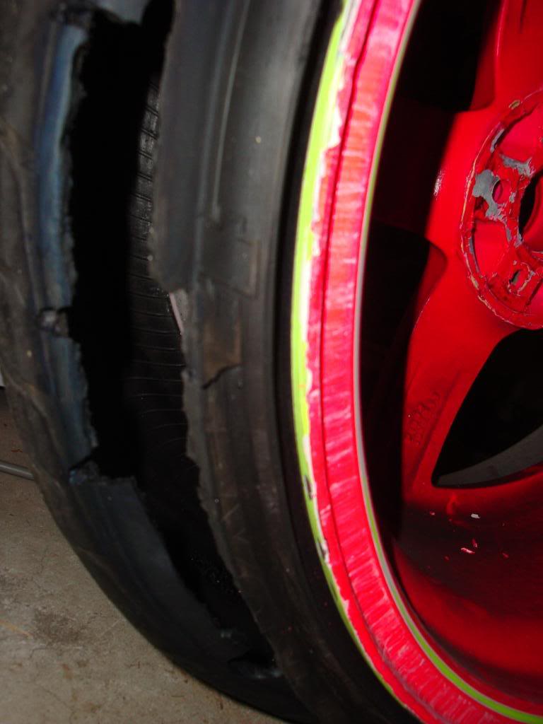

well after 20 min of driving this is what is left of my tire...

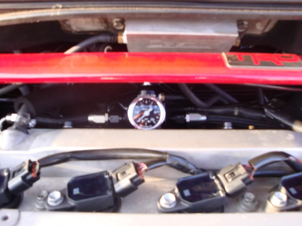

what was under the hood?
Some of the newly installed items:
1. PTUNING : Competition Spec-A 2AZ-FE Short Block
Engine Components Included:
- CP Pistons (88.5mm Bore (STD), 9.0:1 C/R).
- Manley Performance Pro Series Turbo Tuff LightWeight I-Beam Connecting Rods. We worked with Manley to design a lighter rod that does not require lower block notching.
- ACL Race Series Main Bearings.
- ACL Race Series Rod Bearings.
- ACL Thrust Bearings.
- Ptuning Competition ARP2000 Head Studs.
- Ptuning Competition ARP2000 Main Studs.
- Cometic MLS Head Gasket.
- Factory OEM Main Seal.
Options:
- Lighten crankshaft counter-weight to reduce rotating mass while allowing for a free revving, higher rpm engine with reduced oil windage.
2. PTUNING : Competition Spec-SS Turbo Kit (Tuner Kit without ECU & Injectors) - Time Attack Red I/C Piping
Turbocharger:
· Garret T3/04E 57 trim .82 A/R with v-band turbine outlet.
· SS Braided oil feed line.
· SS Braided oil return line.
Exhaust Components:
· Full 304 SS equal length low-mount tubular manifold with a long, narrow angle merge collector (Same as the one on our Ptuning TA tC).
· Tial 38mm v-band MVS Wastegate (new Tial design) (8.5 psi spring).
· 304SS external dump tube.
· Full 304SS 3" v-band downpipe. The downpipe is designed to bolt directly to our Ptuning 3" exhaust system (either turbo-back or s-back).
Piping/Intercooler Components:
· 22"x8"x3.5" bar&plate Intercooler with 2.5" in/out w/cast end tanks.
· 2.75" 6061 aluminum upper intercooler piping w/beaded ends and blow-thru MAF housing.
· 2.5" 6061 aluminum upper intercooler piping w/beaded ends.
· 4" 6061 aluminum cold air intake.
· Upper I/c piping will include a pre-welded bung for Water/Meth injection.
· Tial 50mm v-band Q-BOV (new Tial design).
· 304SS T-bolt clamps for all connections.
· 4/5 ply silicone hose connectors.
· I/C piping in either PTUNING Texture Red or PTUNING Texture Black.
· AEM Dryflow 6" cone filter/ w/ 4" opening.
· 2 SPAL radiator fans.
Options: Garret GT3076R Ball Bearing Turbo Upgrade
Options: Manual Boost Controller
3. PTUNING : Competition 900cc Fuel Injectors
4. PTUNING : Haltech Standalone EMS
5. PTUNING : Competition 3" Polished T304SS TURBO-BACK Exhaust System (Incl. 3" S-Pipe)
TURBO-BACK Exhaust features:
· Full 3" T304SS mandrel-bent tubing.
· Full 3" T304SS 2-piece s-pipe.
· T304SS dual O2 bungs (Installed on S-pipe).
· First O2 bung for factory secondary O2 sensor.
Second O2 bung for use with aftermarket wideband O2 sensor (plug bolt included).
Downpipe exhaust flange adapter-sleeve included for use with 2.5" donut gasket.
· 2.5" ID donut gasket sold separately.
· T304SS exhaust hangers.
· T304SS lightweight V-Band connections (instead of 2-bolt flanges).
· Eliminates exhaust gaskets and thereby any potential gasket leaks.
Fully polished exhaust system with mirror-polished exhaust tip.
· Centralized-muffler design for better weight distribution and stealthy appearance.
· T304SS Adapter for connecting to factory or other aftermarket s-pipe.
· T304SS easily-accessible rear O2 bung for dyno tuning (Installed on exhaust rear section).
· Eliminates faulty lean-AFR readings when trying to dyno a vehicle with a 3" exhaust using a tailpipe sniffer (To be used by your dyno tuner).
All components are carefully designed with maximum ground clearance in mind.
· We've added an extra horizontal hanger & mounting bracket for the rear exhaust section to eliminate excessive exhaust tip movement during hard cornerning (we discovered this problem during our timeattack sessions - burnt rear valance). Most aftermarket tC exhaust systems only utilize one rear exhaust hanger making it difficult to control the side to side movement of the rear section during cornering.
· Off-road use only.
· Made in USA
6. PTUNING : Competition Spec-SS Fuel System
· Kit Contents:
· In-tank Walbro 255 lph high pressure fuel pump
· PTUNING lightweight braided -6 racing fuel lines with aluminum AN fittings
· PTUNING custom return-line conversion kit
· PTUNING billet fuel rail
· PTUNING billet FPR bypass plug
· FueLab mini EFI fuel pressure regulator
· Liquid-filled 0-100 psi fuel pressure gauge
· Factory-style fuel quick disconnects
· All necessary fittings, clamps, hardware and detailed instructions
7. PTUNING/AEM : Competition Water / Methanol Injection Kit
Kit Contents:
- AEM progressive controller. Unit uses PWM to control pump speed (pressure).
- PnP wiring harness.
- Custom bracket for mounting pump.
- Custom bracket for mounting controller.
-Water level sensor to integrate with factory washer bottle.
- Integrated relay that can be used to turn off an electronic boost control solenoid.
- One-way check valve with mounting bracket.
- Three-position factory style switch for turning off WMI and/or EBCS.
8. OS Giken LSD
9. Competition Clutch Steel 12 pound flywheel
10. Competition clutch stage 4
and sooooo much more....!

that looks like ur tire was flat
Old Nov 2, 2009 | 04:03 PM
upStyles's Avatar
Posts: 843
i dont know...dont think so because I just got them mounted like an hour before that happend...but it could of been...almost lost the car because of it
