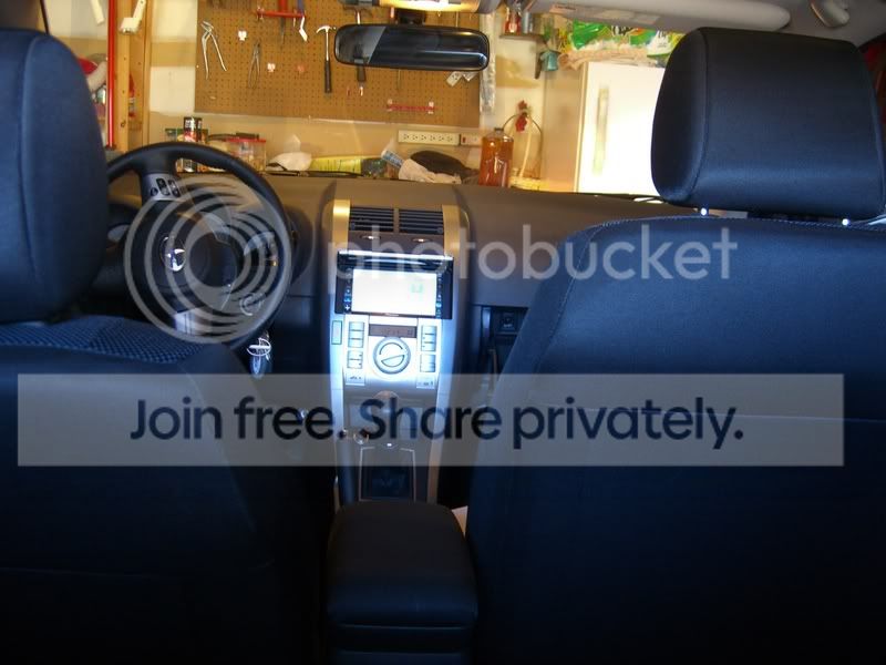

this morning was a busy day for me. I decided it was time to wire my amp in and install my sub. the amp and sub were taken out of my old car before i got my new tC in September. Its an Infinity Reference 1030w SUb and an Audiobahn amp. Nothing top of the line. I just want my music to have a lil more bump, and take the low frequencies off my component speakers. I do not listen to anything with deep bass like rap, so this suits me just fine. my HU is a Pioneer Avic D2, with XM NavTraffic, and a PAC SWI adapter to use my steering wheel controls.

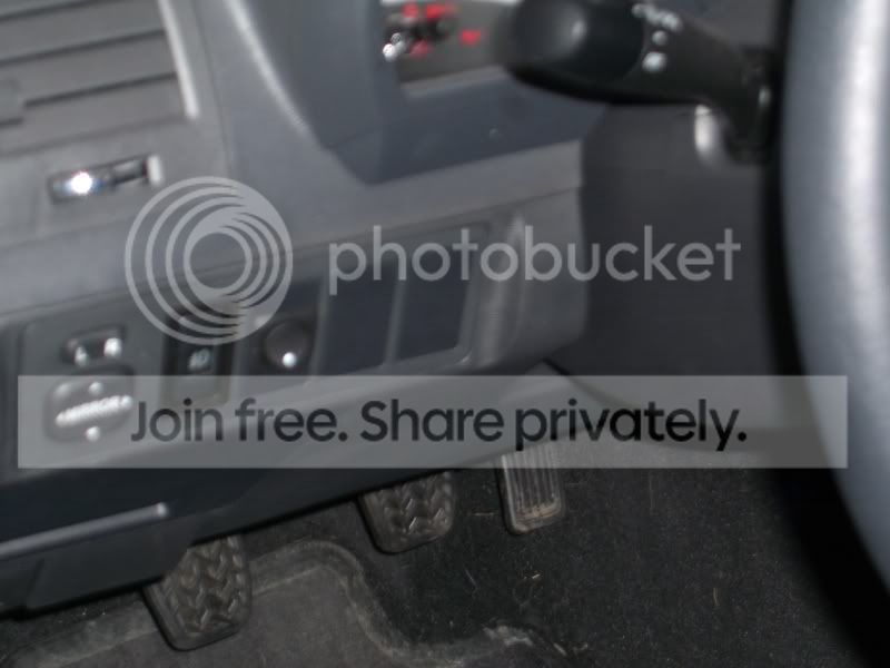

first, i installed a switch to cut off my amp when i listen to talk radio on XM (opie and anthony and ron and fez)

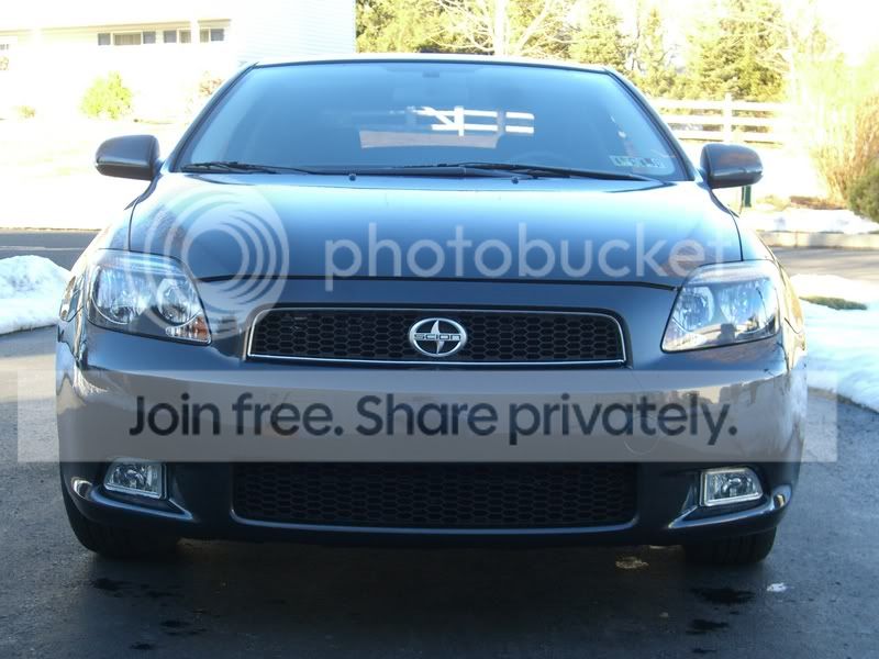

then i went on to my VRD Foglights i got off ebay this week. the installation was a breeze. the only thing that gave me trouble was putting those under engine splash guards back on.

niiice i love how u have a switch. Can you explain how you did it? I'm guessing you used the amp turn on lead?

yup.. just a SPST switch hooked up to the remote turn-on lead of the head unit.. can easily kill the amp for talk radio, turn it back on for music

does that mean that you remote turn on lead is long enough to go to your switch panel? sry i dont know anything about switches. Im planning on getting a Line out converter and have a switch for my sub

you just extend that blue wire to a switch, then from the other post of the switch to your amp
