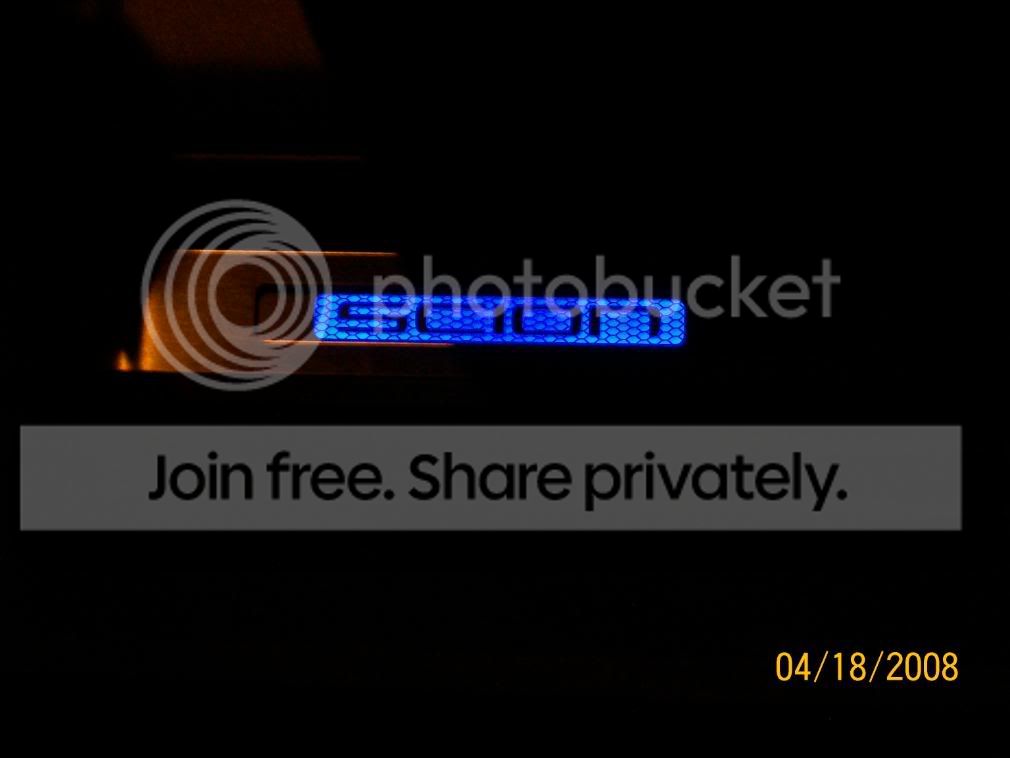

Hearare a few pics of them on my 07 RS 3.0. I like them.
SquallLHeart how har was it to change because my wife wants a pink set and if it's not to hard i'll be doing it soon.

nice pics btw.. nice to see them on a tC for once.. though some daytime shots of it would be nice too.
the sills are illuminated using 2 side emitting plcc leds. though side emitting plccs are somewhat more difficult to find, it's not difficult to solder in regular plccs tilted on their side. lol.
now with pink.. leds in that color tend to fade over time. you can still do it and it'll look nice, but i can't say how well it'll last.
i can think of using a pink vinyl to lay on the background and then white leds to light them up... and also by doing that will also cause the sills to look pink-ish too when they're "unlit" (as in it's daytime and the led's brightness isn't lighting them up well)

Thanks for the help i may try and do the white leds with the pink overlay. AS for day shots i'll try and get some tomorrow or Sat after i clean the car. It's been awhile. LOL!
