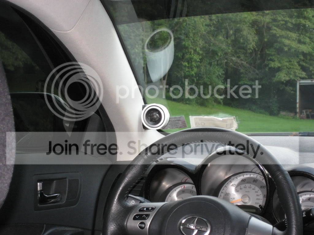

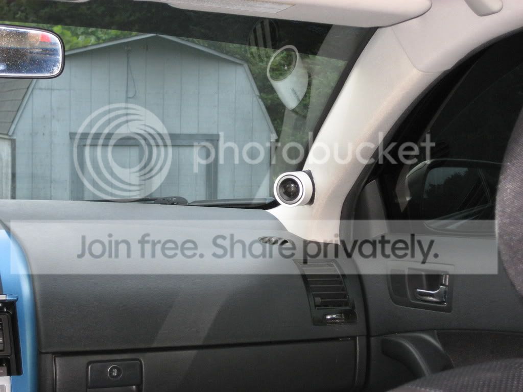

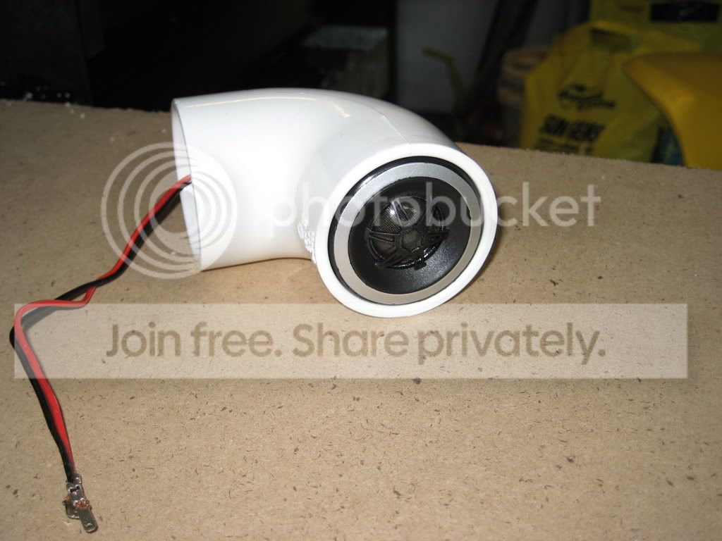

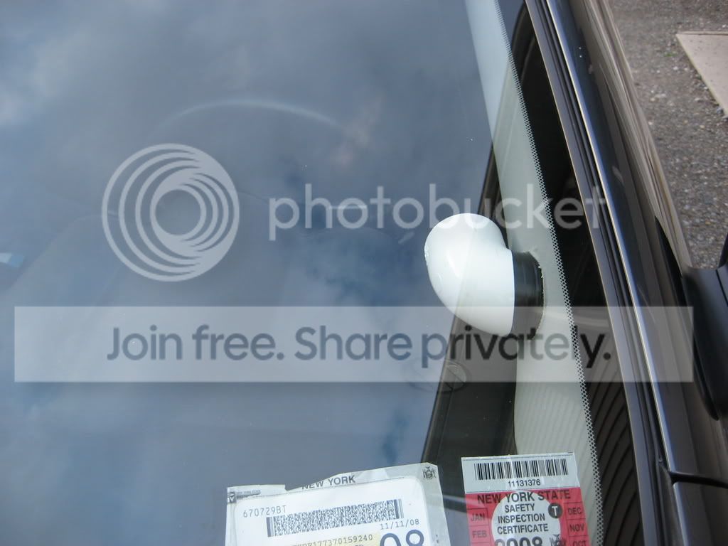

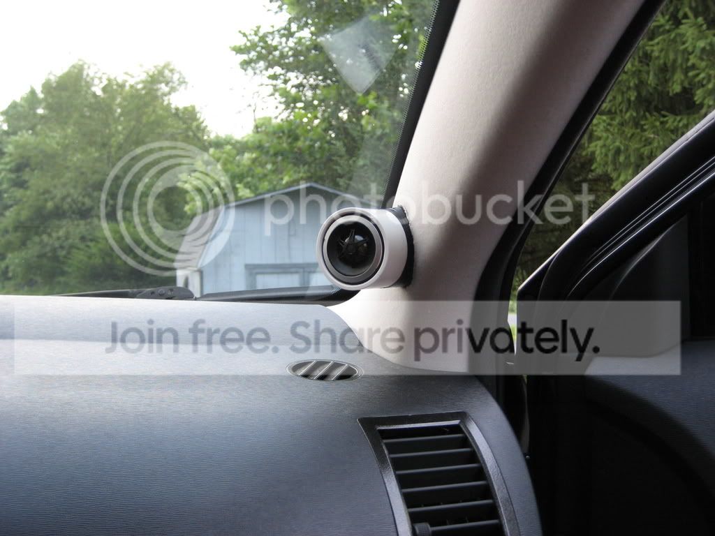

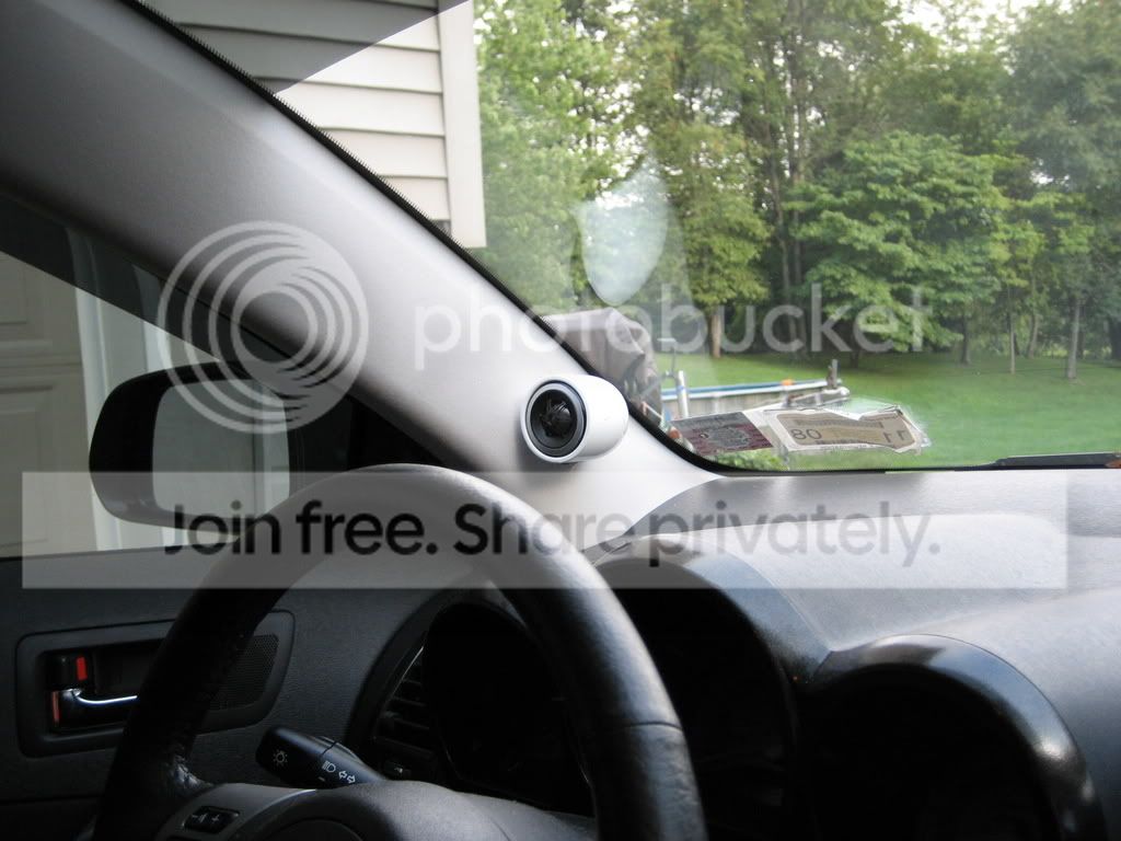

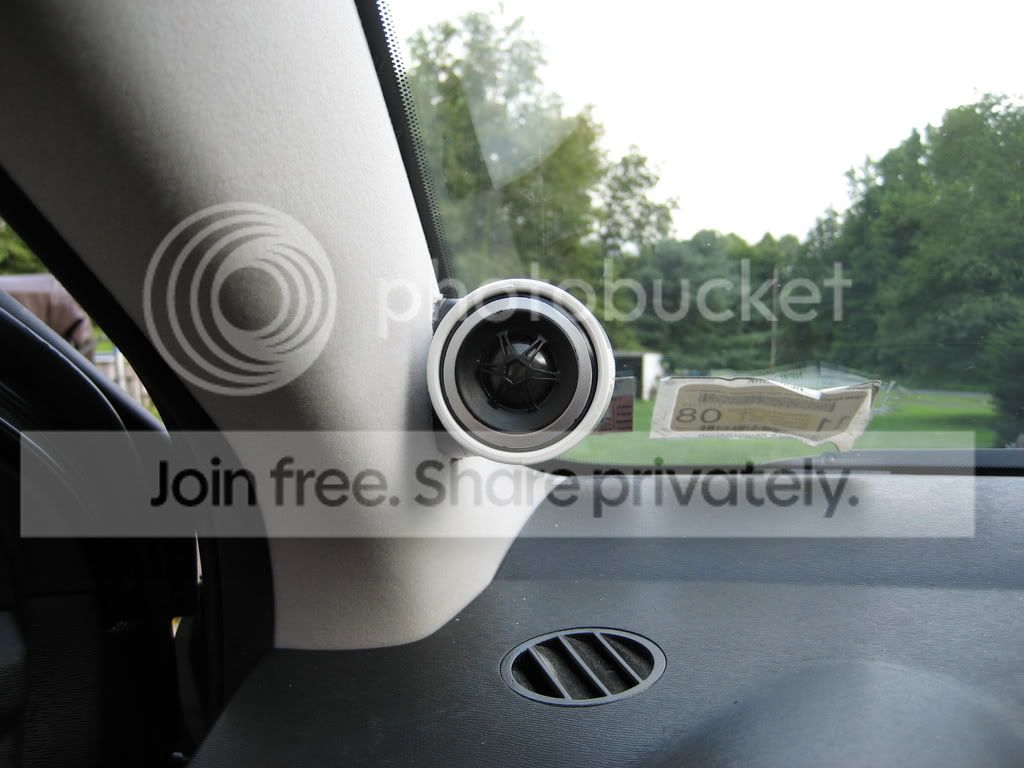

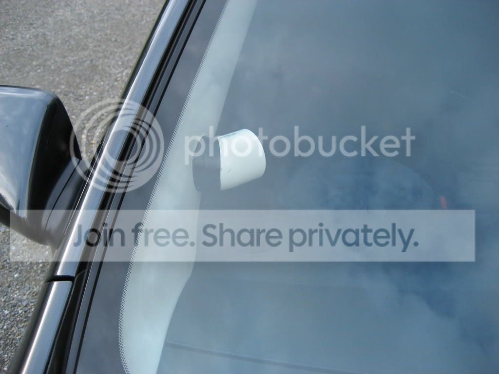

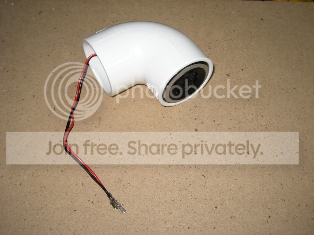

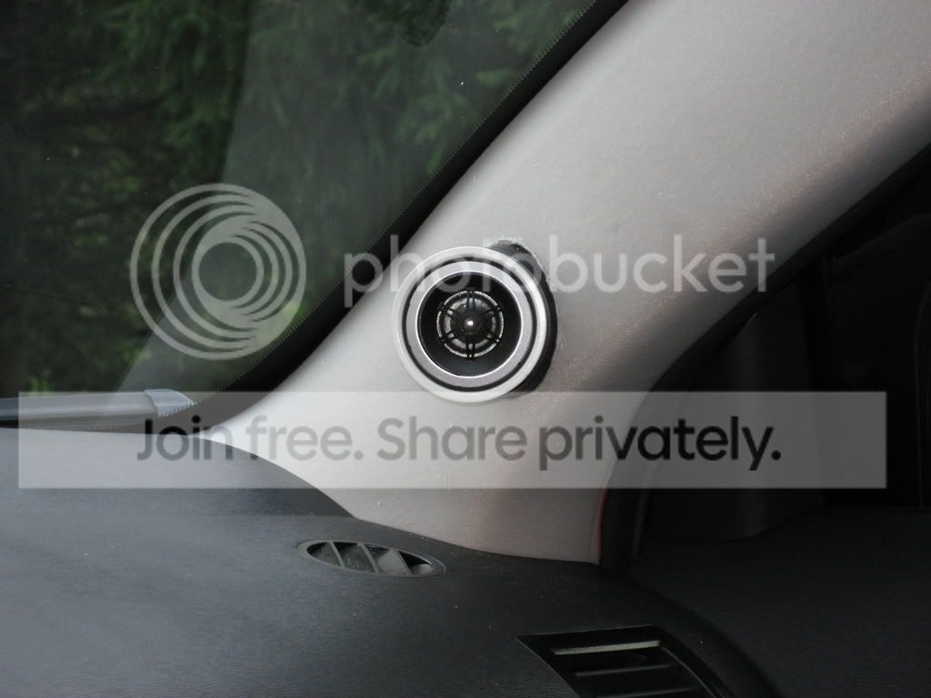

since i had the day off today and my new mids didn't show up today i figured i'd start on my pillars. they are the RSD tweeters aimed perfectly on-axis. used some pvc pipe elbow fittings and drilled holes in my pillars for the pods. as of now they are just pushed into the pillar. i am not sure exactly how i will finish them yet and the progress may be a bit slow but this is them as of now.
a view right from the drivers side headrest showing that the left one is indeed 100% on-axis.
a view right from the drivers side headrest showing that the right side is also 100% on-axis.

Are you going to leave them oriented that way, or make the angles equal? I'd think the sound should improve by changing the left side to match the right (implying on axis with the passenger headrest).

yes, i am leaving them aimed that way, that was the point of my doing this. it's called "on-axis" to the driver. screw the passengers, they don't care about SQ. in the drivers seat it sounds sooooooo nice like this. the top end is so much nicer and there is a lot more detail.
