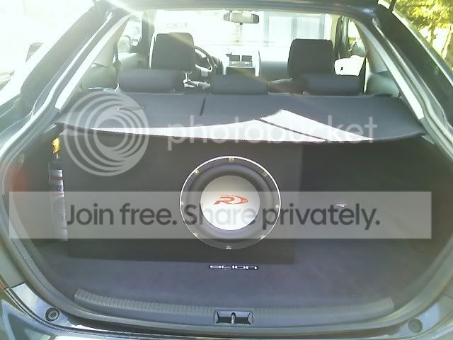

I just want something simple to hold a 10" sub and amp, I found this on ebay
http://cgi.ebay.com/2005-07-Toyota-S...ayphotohosting
...but would this be a relatively easy box to make? I have the basic tool, I figure it might be $40- $50 in materials. Would I just be better off to buy this? Has anyone purchased one of these already? Thanks for the feedback.

it doesn't look easy to make to me. i actually like those boxes but i would probably just get one of his 12 inch boxes. it'll be a little louder than one 10 inch and still not take up your whole trunk. i would probably do a setup like this but i love the box that i made for myself plus its louder than one of those boxes will be since mine is ported and bigger.

I built something very much like this setup.
It's not as easy as it looks. It's not a weekend project. You have to get all the materials, make the mdf rings, mask the whole rear hatch area.........it's a project. If you've done work like this before, then it won't be a big deal. If this is your first venture, then don't! You'll probably make a bunch of mistakes, spend alot of money, and you won't be happy with it in the long run. Good luck.

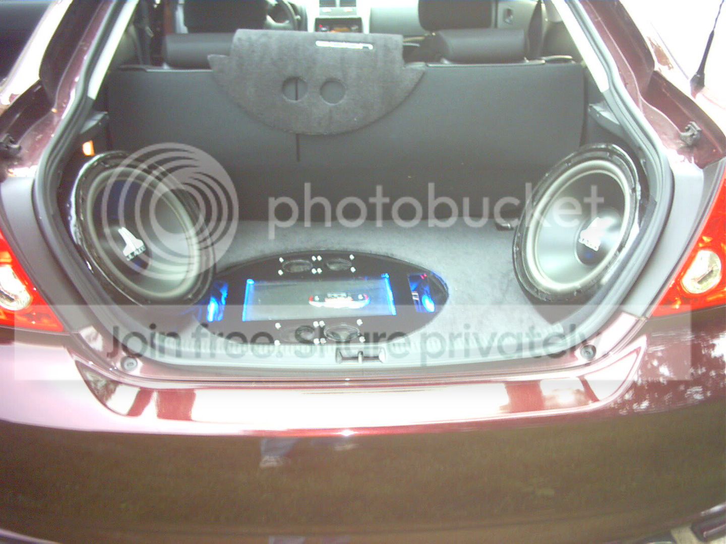

You want the internal structure of the box to be as solid as possible. Screw it together, and glue it using a wood/yellow glue. Make sure you glue all the ends first. See....the mdf soaks up glue like a sponge. Glue the ends together first, then after it dries, glue all the pieces together. Screw them together using wood screws. But don't screw into the ends of the mdf, it's like cardboard and will pull apart even if drilled out first. It's ok to screw into the face of it though. So take a piece of scrap wood and screw both corners together that way. Then after it's all dry, go back with self-sealing non hardening caulk. This it to make it air tight.
This will show how it should look.

Ohh man...only thing is im worried i wont be able to put screws in around those sharp edges? Soo maybe i should just wood glue it then caulk it to make sure its secure for air tightness? First time doing a box, but i got my bros help and he knows alot about this stuff. Maybe I would have been better off buying....but i wanted to do it just so i could say i did it lol! Watcher did u do fiberglass molding of ur int? Or did u do it w/ wood? Im not really a big fan of fiberglass (not much working exp with it) so i was trying to avoid it on the back, but im gonna fiberglass the front. Kind of like this DIY, but in the left corner pocket near tail lights....

ok, so when you do a plain box, its just a matter of calculating width x height x length to get the volume. But when you can irregular shapes like the box above its get a lot more complicated. Is there a trick to simplifying the equation with irregular boxes, or do you have to treat each section as it own equation and then add them all up? meaning the volume for the trianglar parts of the box are different than the square parts......

I've done two completely seperate types of boxes. One, I did was 100% fiberglass. Not including the rings. The other I did was 100% mdf.
