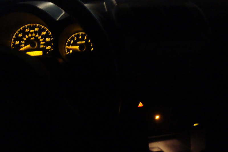

Headlights on:

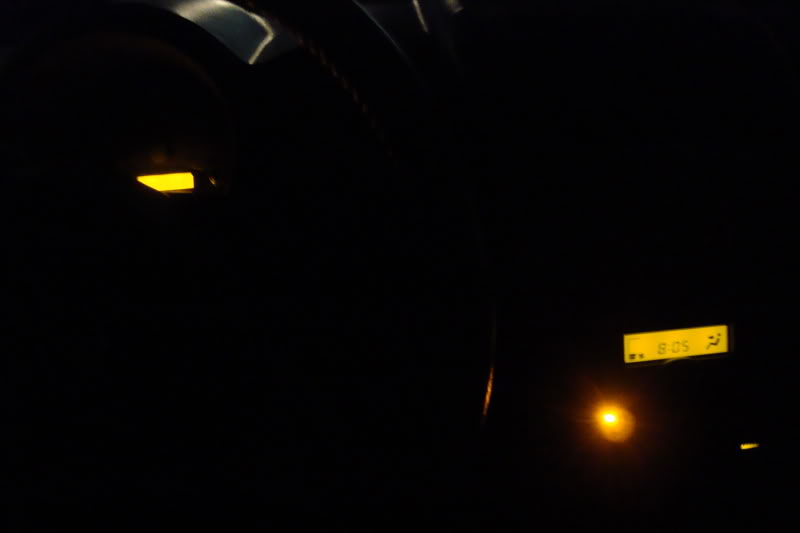

Headlights off:
As you can see the clock is illuminated with the headlights off, but not when on. Is that how its supposed to be or did someone mess up the wiring?

you have an '07 huh?
https://www.scionlife.com/forums/sho...d.php?t=158086
4 days ago? purchased used...
that dealership sell it "as is"? or.. with some warranty?
if no warranty.. get it fixed.
Old Jan 6, 2010 | 04:08 AM
customs21's Avatar
Joined: Jan 2010
Posts: 24
Didn't know that was the HVAC problem everyone kept talking about. I got it through dealership auctions (uncles friend works them for dealerships) but it only has 33,700 or so on it, so it still has the dealer warranty. So, take it to Scion then to have it fixed?
Old Jan 6, 2010 | 07:18 PM
SquallLHeart's Avatar
Posts: 15,699
they won't fix it. mechanics and techs at dealerships only know how to replace it.
they should replace it for free.. if not. screw them and have someone else fix it for you.
i'll offer a free fix if you pay for shipping both ways.
Old Jan 6, 2010 | 08:52 PM
customs21's Avatar
Joined: Jan 2010
Posts: 24
Thanks man, but if the dealership won't replace it and all it is is that solder problem like the thread said, then i'm more than capable of resoldering it.
Old Jan 6, 2010 | 10:42 PM
Posts: 15,699
that works perfectly as well.
