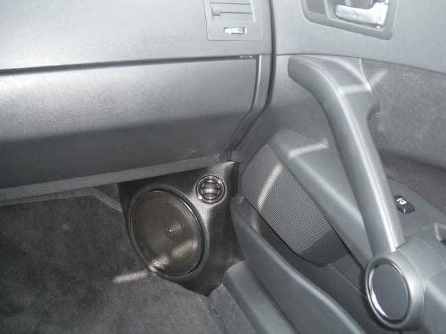

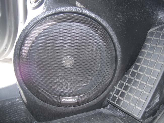

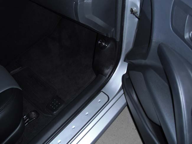

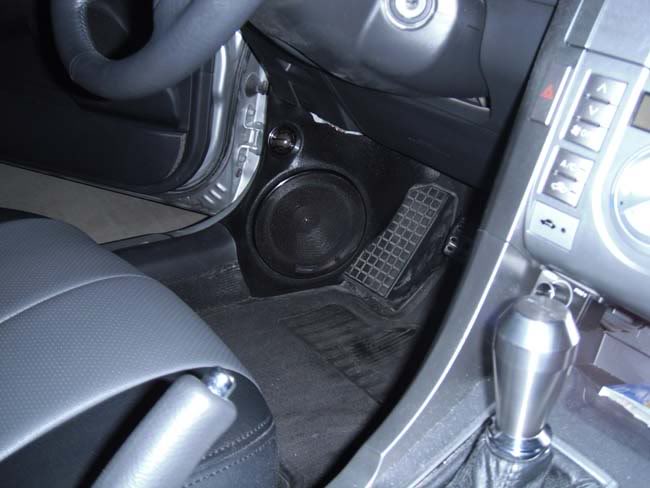

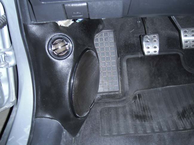

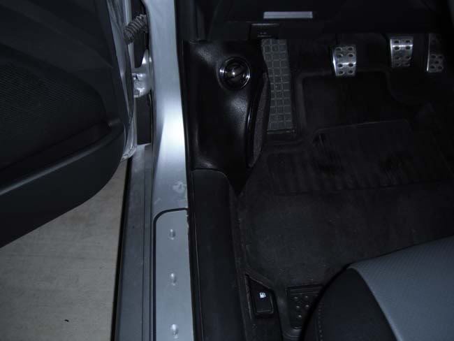

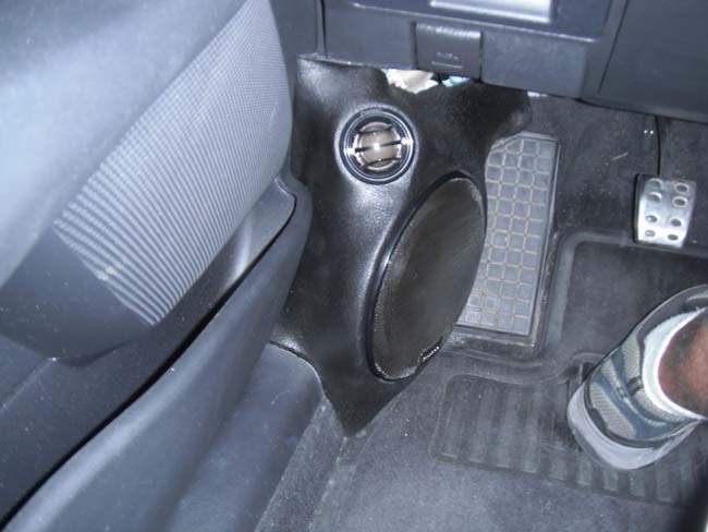

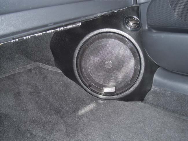

Wow, this project has taken forever. It's a lot of work and I only have a few hours here and there to work on it. I'm finally done and I have pictures of the final product. I don't like taking pictures of the step by step as I build so I don't have any. Just the end result.
I have to say the color in the pictures really looks different than in person. They look so much darker than the rest of the plastic interior in the pictures, but in person they look much more similar. I did end up using the duplicolor truck bed liner and I'm happy with the result.
The speakers are the Pioneer Stage 4 TS-C172PRS and they sound amazing!

Wow, those kick panels look great. Sell them to me

After all the work I put into them, the value is way higher to me than what they are actually worth. Honestly, I would not let them go for under a grand! LOL I know, that sounds crazy, but I really don't feel like making more.
And yes, I realize that maybe you were being a little sarcastic.

those look f*($ing amazing
great job man!
