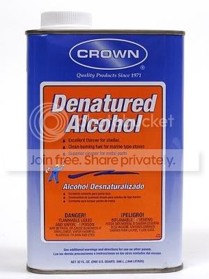

Now for another question...how do I get all the glue and foam off the insert? I have been using a 380 grit sanding block, but I think that is too fine for getting all the stuff off. I looked at adhesive removers, but I was scared to use it on the plastic for fear it would eat through. Any suggestions on a plastic-safe adhesive remover?

Save yourself a headace. Go to lowes and get this
then get you a spay bottle, spray a little section and use a scraper and just scrape it off. This will save you so much time and will not hurt the plastic at all. Once i got all the foam off then i took some 100g sand paper and smoothed it out. make sure you let it dry completely before you spray your glue on there. You want to make sure you get the foam off of there so you dont have any bumbs in your final results and also so you dont mess with the adhesion of your fabric and the plastic
