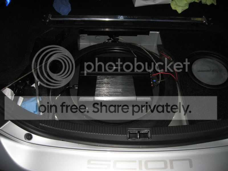

My only question left is.... how do i mount the sub? I see that its recessed into the top (plate?). He said that he used a baffle, but how would I make that? Can I buy one that will owrk for the SQ10?
Also, how deep do I offset it so that it sits correctly flush with the top, or how its suppose to be?

Alight, heres the easy way. Trace the foam insert, cut out a piece of .75" MDF in that shape. Next make a simple rectangle box that has a total height of 4" and a volume of .5cF. Cut the hole out of the box and mount the subwoofer. Cut out a corresponding hole with a diameter of 10.25" out of the larger wood piece (the one which you traced of the foam insert). Nail the two pieces together.

Old Apr 12, 2008 | 01:20 AM
nebster's Avatar
Posts: 8,961
From: Team SOLO
let me take a picture quickly... not hard to do. make two pieces of wood and nail them together
granted this is for a box with two sq10's but you get the point
