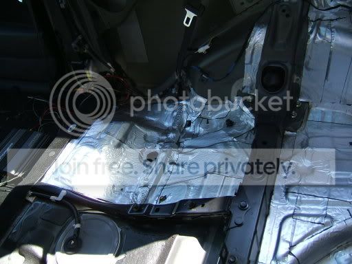

Rear Drivers Side Floor
And Hatch and Rear Floor all just about done.
