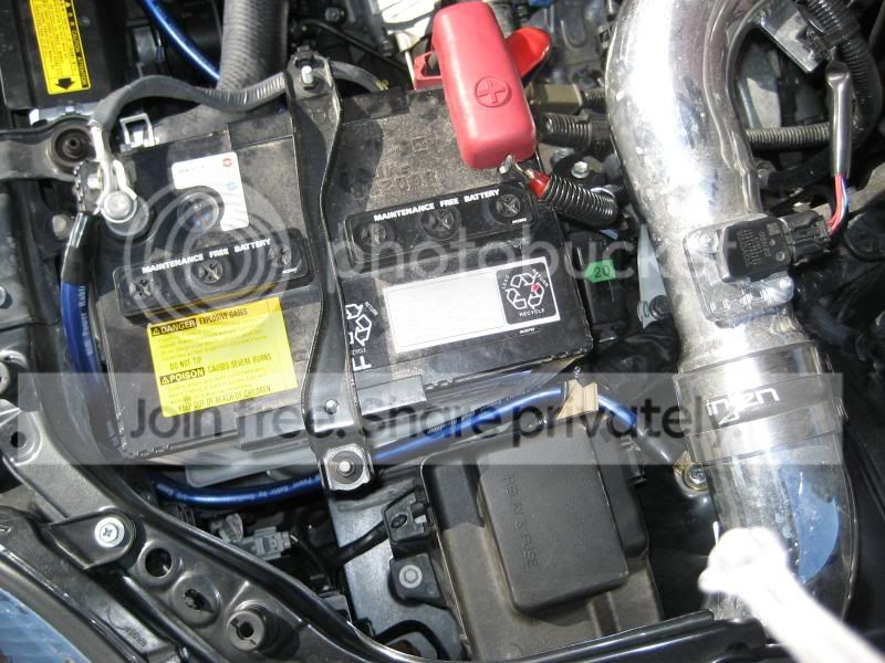

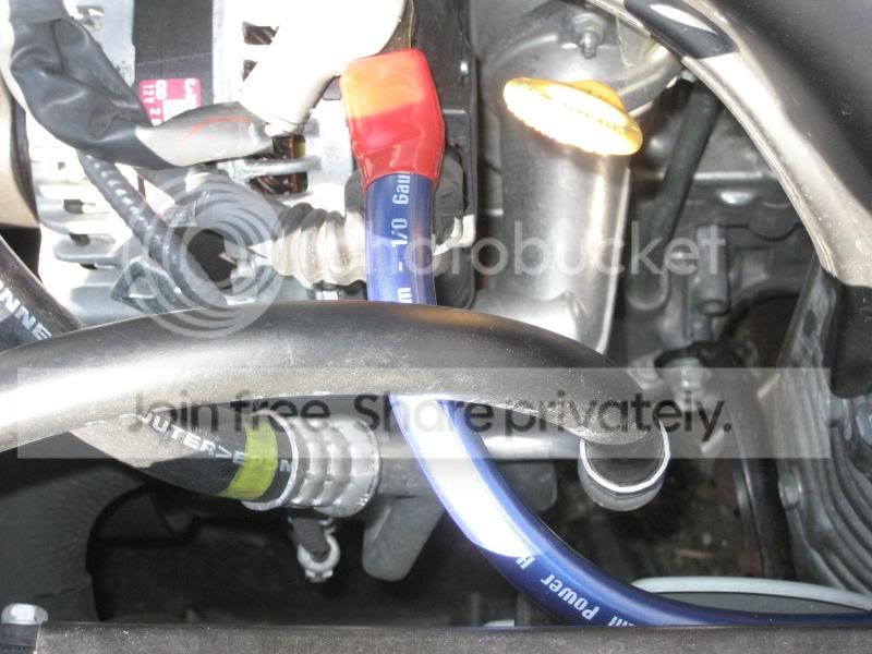

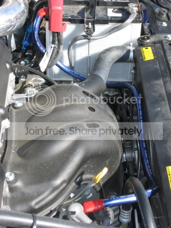

ok i did the BIG 3! went perfectly smooth, no problems at all.
my voltage seems to be constantly at a higher number(especially when driving). my voltage was never above 14 except for first thing in the morning on a cold start. right when i started the car up(which had been run maybe an hour earlier) it was at right at 14.4 and stayed above 14.2 while driving at average speeds. at quick stops at stop signs or stop lights it stayed about 13.9-14.2 for the most part. i was sitting in line at the car wash for about 15 minutes playing my music at a moderate level and it slowly went down to about 13.4-13.6 and stayed there until i drove off. with the car off listening to music at a moderate level it seems about the same as before, a constant 12.4-12.5 after a few minutes of playing.
i don't really seem to have any voltage drop. i'll report back next time i drive it at night with the headlights and stuff on. but i don't expect anymore than a .2 drop. everything seems pretty stable now.
here are a few new pics of the wiring, the trunk and the car since i just washed it. it is quite dirty under the hood, but it's winter.

I think those are the best places to run the wires for it. if you run them exactly the same as me you'll need only 8 feet of wire and 6 ends.

Old Mar 3, 2008 | 12:59 AM
combatsteve's Avatar
Posts: 462
do you have anything securing the cable from the alt to the battery? If not you better secure that and I would wire loom it to help with a little heat protection.
Old Mar 3, 2008 | 01:09 AM
Tcguy85's Avatar
Posts: 2,434
From: Hyde Park, NY
i will put a zip tie on it tomorrow. but it is pretty damn secure like it is. and no on the loom. i think the wire loom looks like dookie.

did you make that ground or was it already there??
Old Mar 3, 2008 | 01:16 AM
Tcguy85's Avatar
Posts: 2,434
From: Hyde Park, NY
i think it's one of the spots that the stock intake bolts to. i just sanded it bare and used it. seemed like a nice solid point.

Old Mar 4, 2008 | 12:49 AM
Luc1f3r's Avatar
Posts: 1,643
From: Clearwater, FL
youre missing the fuse from the alt to the battery...
Old Mar 4, 2008 | 01:03 AM
Tcguy85's Avatar
Posts: 2,434
From: Hyde Park, NY
nope. it's not needed. some believe it is, i don't believe so.

Old Mar 4, 2008 | 03:35 PM
blazeplacid's Avatar
Posts: 845
quick question about the grounding spots
are all those bolts and mounting holes there or do you have to drill and find new bolts?
if so do you remember the size?

Old Mar 4, 2008 | 10:57 PM
Tcguy85's Avatar
Posts: 2,434
From: Hyde Park, NY
the spot on the motor was an empty hole that was already threaded. i think 12mm, the spot on the frame i think was a mounting spot for the stock intake box. so if you have an intake it should be an open 10mm threaded hole.
