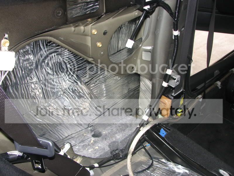

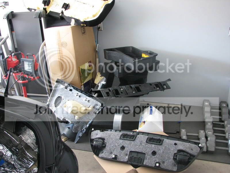

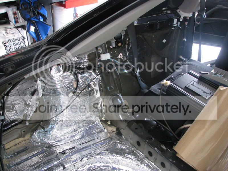

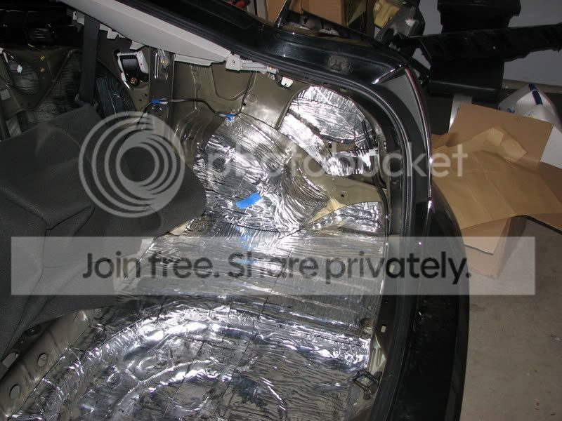

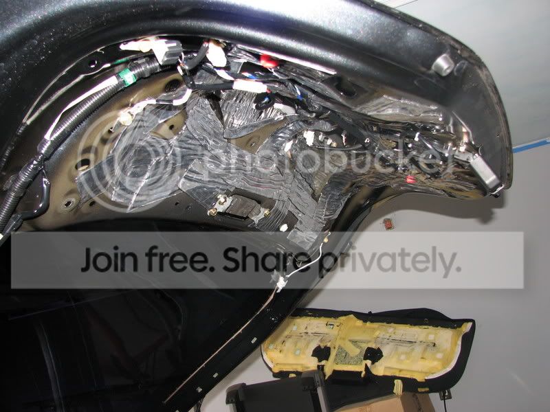

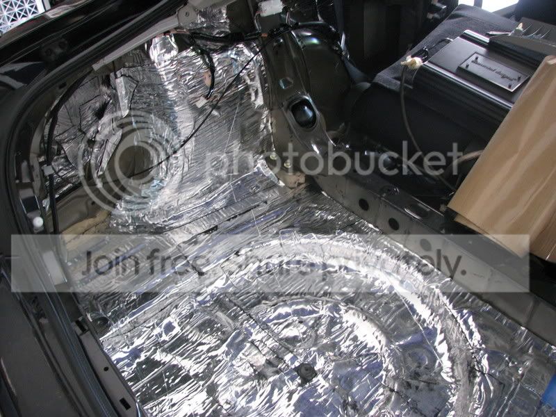

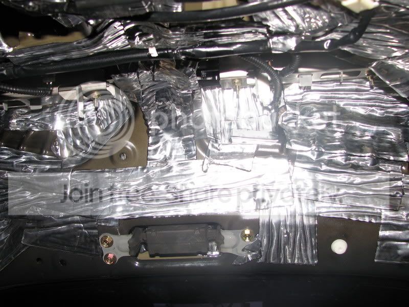

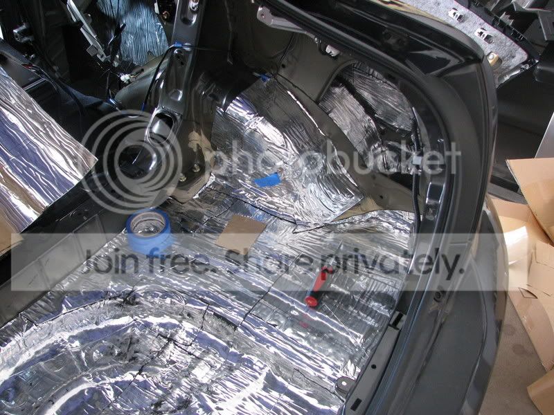

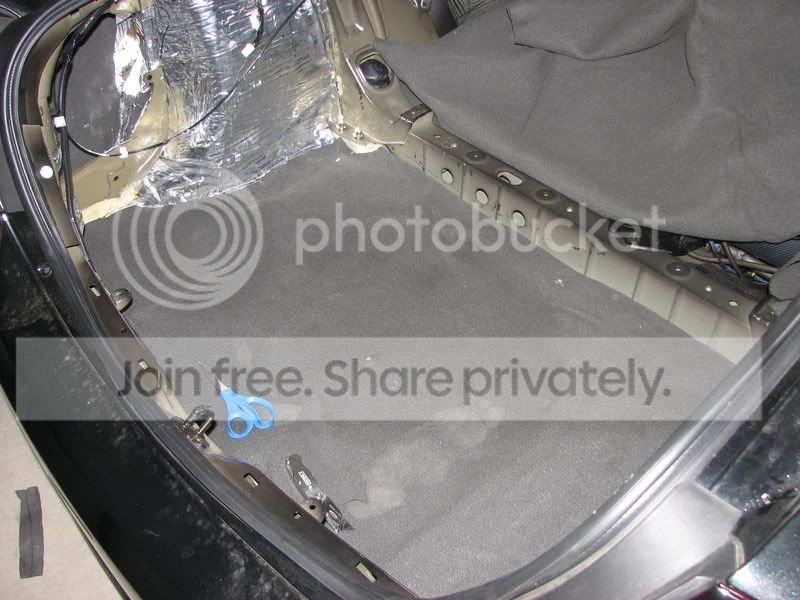

I deadened the doors and the floors a few months back and have been waiting to finish the job. I finally ordered some more raammat and got to work. I did the hatch area and the rear panels (behind the rear speakers). The car now has about 180 sq ft of sound deadener. It now sounds like a luxury car when driving!! Anyways, on to the pics.
Disassembly
Trunk
Trunk after Ensolite
Hatch
Rear panel
I also added Ensolite to the rear panels, I just forgot to take pics. For anybody looking for a good sound deadener I highly recommend Raammat. The stuff is awesome. I put it in my doors a few months back and it is still holding up nicely (even in the AZ summer!)

I have spent probably about $400. That includes the Raammat, the Ensolite, the adhesive for the Ensolite and shipping. If you talk to Rick he can probably give you a Scionlife discount, he posts on here.

Good luck. When you do decide to do it, make sure you pay close attention to the rear panels. That is where the majority of the road noise seems to come from. If you look behind the panels there is nothing there... just the sheet metal.

The difference was night and day! My wife was amazed at the difference. Even shutting the doors and the hatch is different now. It sounds a lot more solid.
by rear panels do you mean the area right next to the rear back seat, or the side panels in the trunk area?
Old Jul 18, 2007 | 06:47 AM
rocketgyrl's Avatar
Posts: 487
From: Littleton, CO
Both. Double up on the rear panels if you have enough material...the results will be well worth it!

Does it really make a difference on the hatch? (Pics #7 & #8.) This will be my next project after I save some $crill because I just bought a Full TBL.
