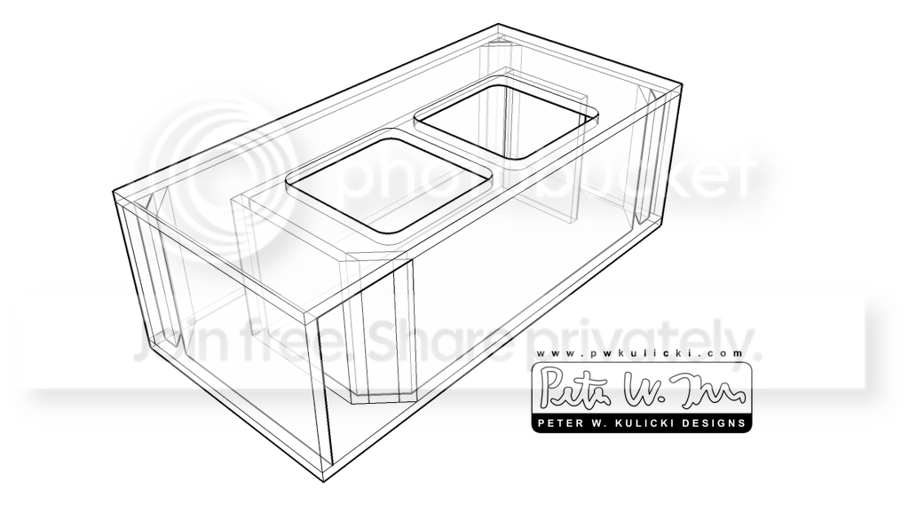

TTB doesn't design boxes tuned to a specific number, the design will give a flat cabin response from 33hz-100hz, and a decent extension all the way down to 20hz without a sharp drop off.
Subs will be two 10L7s. Its gonna be loud but retain sound quality.

Not for SPL, no huge blip in the response curve, thats why I said it is flat. The over box is about 3.5cuft before port and sub.

But I trust Pete and his design, I haven't heard a bad thing yet with people using his enclosure. I hear stupid comments though from people that never used his enclosures before.
I was skeptical at first, also with paying to get a design. But at least he does do the acoustical engineering behind it though. The box is specifically designed for those sub and the tC. Especially he takes into account cabin gain and impedance rise. So its not a WinISD modeling in an infinite space.

Its $50 for the design.

Yep everything you need, cut list and a few 3d modeling.

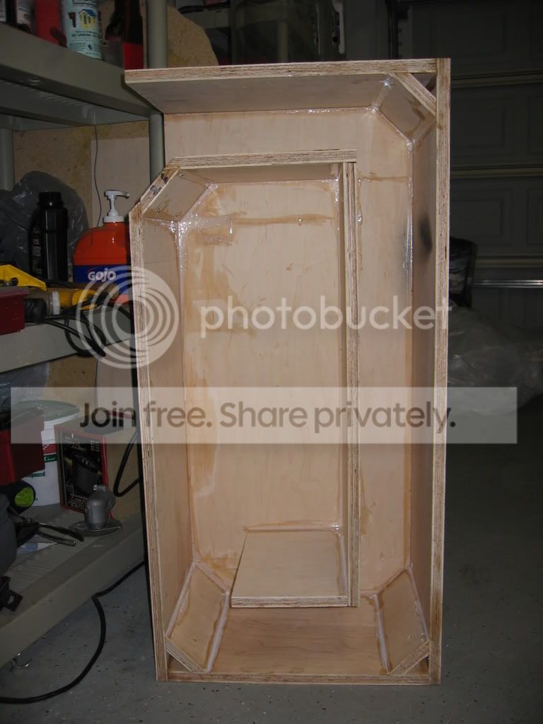

Old Feb 17, 2008 | 11:48 PM
trialsindude's Avatar
Strictly Scionized
Posts: 1,284
From: White Marsh, Balti Co., MD
Cutting wood...
Test fit:
Almost all together:
Glue everywhere! Titebond III FTMFW!!! LOL
Gotta go to my other house and grab my jigsaw to cut out my squares!! LOL
Oh yeah mind you that all those cuts were done with a dewalt 18v cordless circular saw! LOL even the 45degree cuts!
